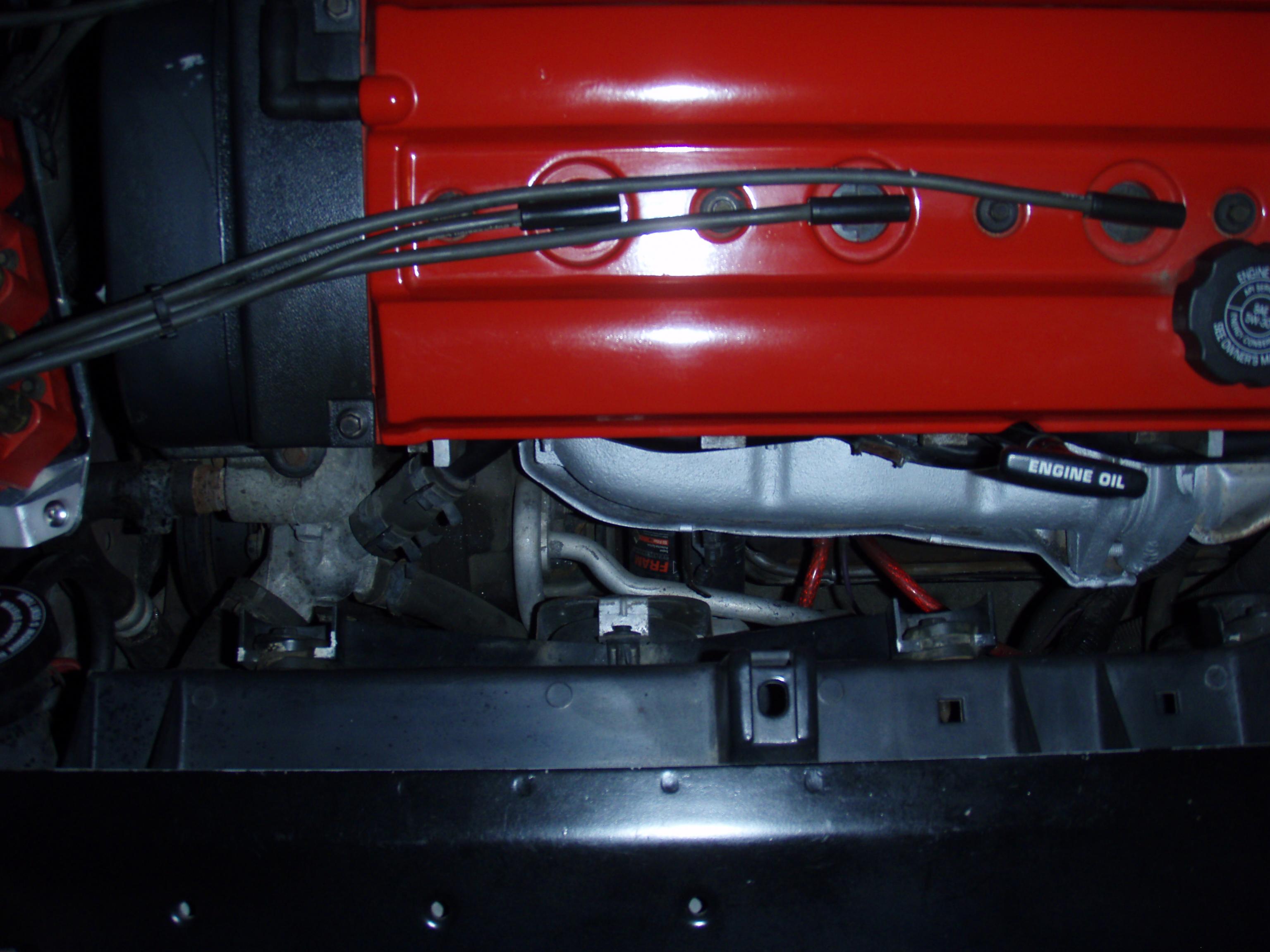

              dont pull it to polish it. buy a new one to put in and polish that one. and the lower rad hose housing too. that little three nippled thing there with all the coolant lines comming from it could use some shine too if you ask me. your valve covers look pretty badass though if you ask me
