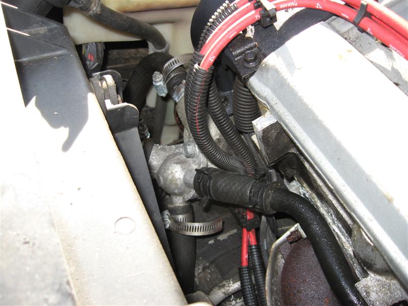

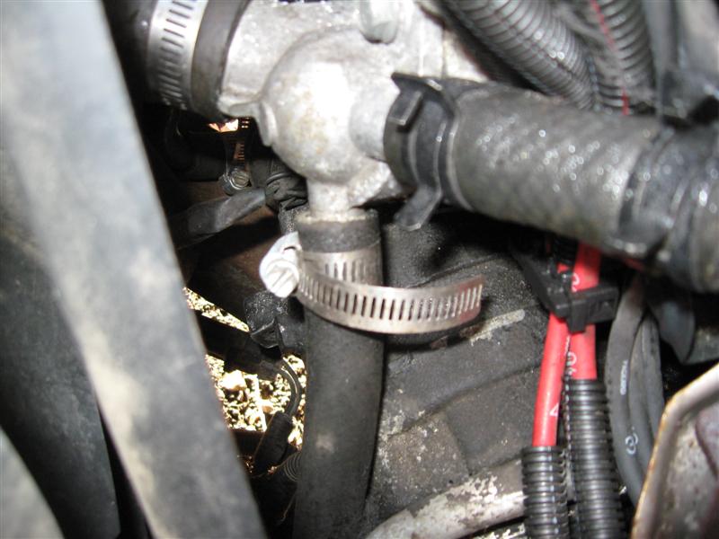

    Well, got a few pics. The hose that goes to/from the oil filter is the one with a hose clamp that angles straight down. The hose looks to be about a foot long and is very easy to get to.. Measure it when you get it off but, it looks like 3/4" to me...
    Good luck,,
    Tom...

        Totally lost. I have never seen anything like that.
        • 1988GTU
          LB62LHObbqftmfw
          • Nov 2005
          • 2475
          Swap out cooler for non-cooler adapter housing and delete it. Don't forget to plug/cap the other end.

            Just replace the foot of line, easy.. I can almost get it from the top...
            I'm pretty sure that is the line he's talking about,, the only other line with coolant that low is the metal heater core return(?), or there is a short line that goes from the filter to the block... The 93s, like he has, used an adapter type of deal that goes between the filter and the engine block with coolant lines attached.. I suppose it could be eliminated but, it seems easier to just replace a simple hose!! IF we ARE talking bout the same thing.. If not,,, sorry... Check out this link:
            http://60degreev6.com/forum/f101/eng...ny-swap-t38381
            Check out the sixth pic and you can see EVERYTHING that's on the engine...
            I used a regular piece of hose,,, his pics show the factory hoses that are shaped with all the bends to make it look nice... Nice, but, not really critical...
            Good luck,, I can get better pics, but, that engine is on the other side of the state!!
            Tom...

                antifreeze leak/bad hose
                I think you actually got what I was talking about, only thing is if you look at the first pic that was posted the main hose that you see there should be easy to fix no prob there there is another hose there that is the same size that is even worse and I see one end of it but the other end goes up inside the engine. This is the main one that needs to be repaired.
                =Joel=

                  On pic #6, that I posted you can see that other line just to the right of the oil filter. It's pretty much U-Shaped. I'm pretty sure that there is a nipple that just threads into the block that the hose plugs onto. If you remove the oil filter and the "easy" hose you can probably see where it attaches.. Unfortunately THAT hose will probably need to be a pre-formed item to make the sharp turns,, a regular straight hose might kink.. It might be a dealer item,,, don't know for sure tho...
                  Good luck,,
                  Tom....

                      NO, it's a COOLANT line, as in Anti-Freeze. That hose you are talking about (the hard one to get at), well coolant flows from the block to the oil filter through that hose. From there (the easy one) it runs up to the junction near the water pump. I suggested removing the oil filter to make it easier to see..
                      Tom....
