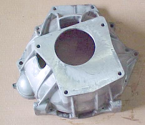

              I found this bellhousing. It's supposed to be from 95-97 3800 f-body. It looks like you can mount it straight or angled. Is there any specific pros or cons to either mounting position?
                That actually looks like it can be angled to one direction or angled to the other... odd...

                  I can tell the holes were never drilled and taped also that's a push type clutch
