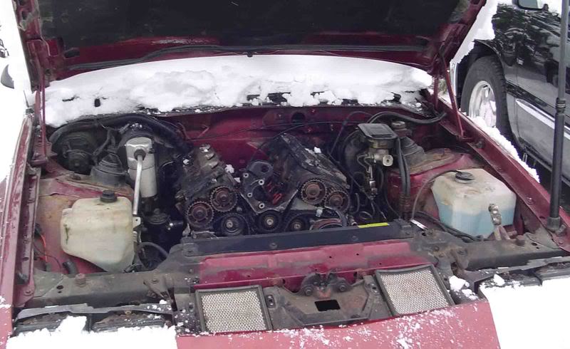

                      Looks great in a F body though!

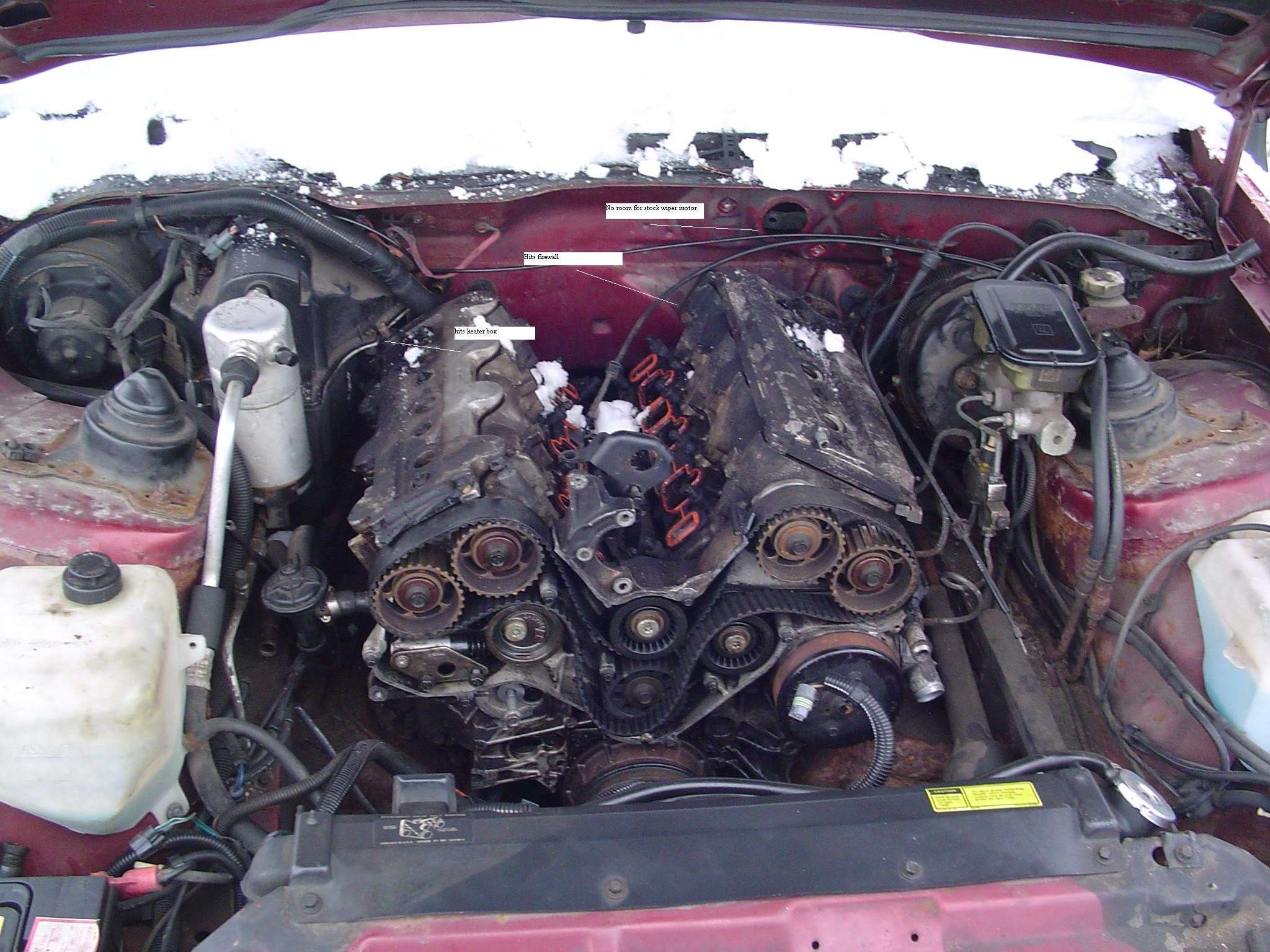

                        In that last pic it says "hits firewall" "blocks heater core", and "no room for wiper motor". I'm assuming that's attached to a transmission in stock location but hard to tell anything other than that. Or maybe that's just where the stock oil pan clears the k-member.
                        Then again it looks to be about the right place for a V6 to fit.

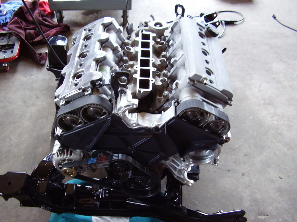

                          Yea I'm sure you could do a bit of modification though, The big deal is the intake and power steering pump. Is it possible to use a 96/97 intake but swap the UIM around only? There's no room for the thermostat housing without cutting the power steering bracket. Hard to tell by pictures, Wish I had one laying around to experiment on

                            The upper doesn't look reversible just looking at the bolt hole locations.
