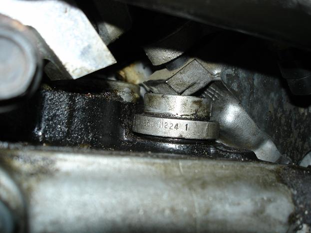

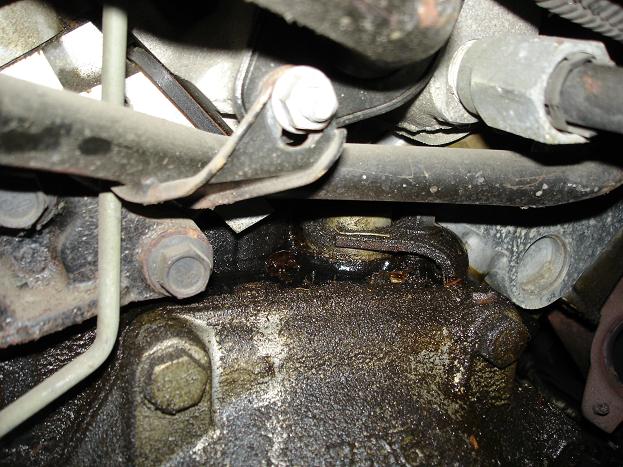

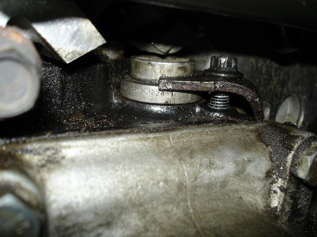

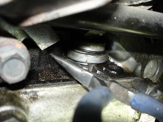

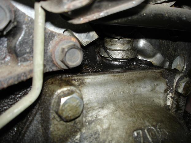

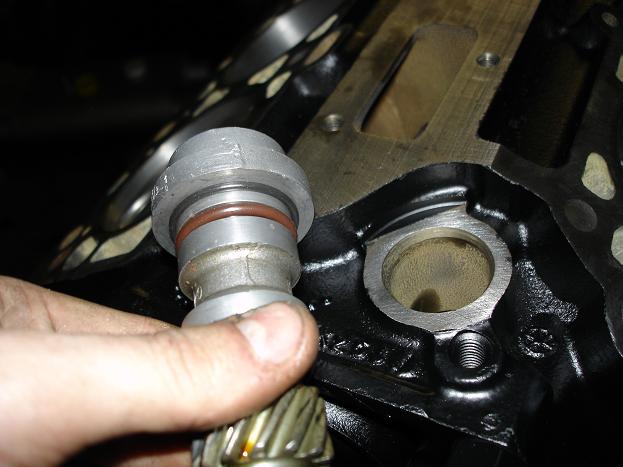

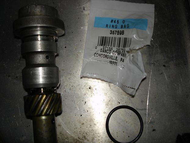

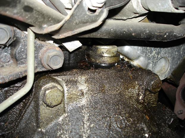

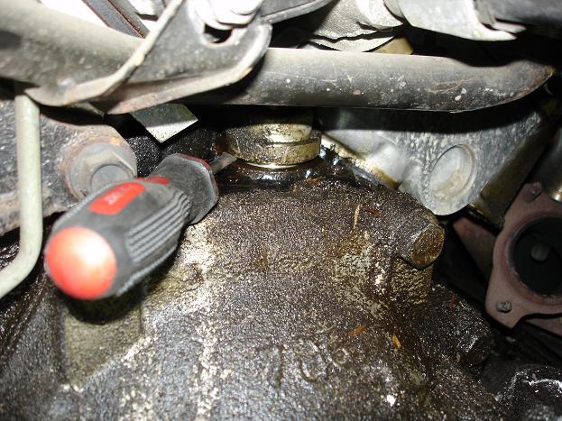

                Cheater's fix...
                Alright, there is another way around pulling the head and fixing the leak... I came up with this one when I was assembling my 3.4 DOHC. And I tested it on a friends 95 Monte.
                First I started by removing the airbox, intake tube, MAF and IAT. Then remove the negative battery terminal. The driver side cooling fan and the crossover... Thats the demolition needed to get to the little bugger.
                Clean the area with your favorite solvent, Carb spray or brake cleaner usually does wonders.
                Remove the clamp with your trusty 13 mm wrench, ratcheting wrenches really kick ass for this application.
                Get an O-ring... The one I got was found in the plumbing section of the local ACE hardware, it was a #45 whatever that means...
                Slip the oring over the top of the oil pump drive assembly.
                Pry the assembly up out of the block, and carefully slip the oring over the wide part of the assembly, then seat the assembly back into the block, and replace the retaining clamp.
                Replace the crossover, the fan the battery terminal and the airbox, MAF and IAT.
                Done.
                The reason this works so well is that there is a taper on the inside of the block and when the clamp presses the assembly and the oring in, it seals it exactly the same way a hydraulic O-ring seals against thousands of psi of pressure, by capturing the Oring on 3 sides.
                The pictures explain all, I had a spare oil pump drive assembly for a couple of those pictures.

                  Fiero obsessed's methods is the one I went with when I had this problem. Unfortunately for me I did'nt know about this site so I had a hell of a time finding the leak in the first place. The one big important thing you need to do is clean the shit out of it. I used engine degreaser spray and finished it off with a can of brake clean to remove all traces of oil. Over time the O-ring will start to 'settle' and if theres any leftover oil in the sealed surfaces a new leak will form. You can get er' good by doubling up the o-ring with oil resistant RTV sealant as well and spin the plug as you lower it down to seat it.
