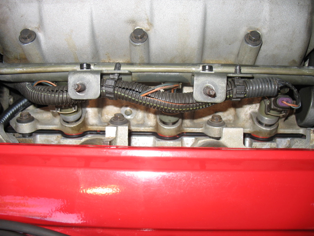

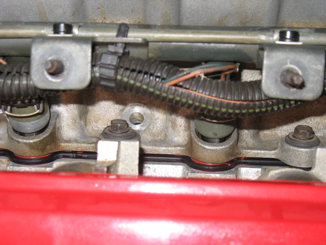

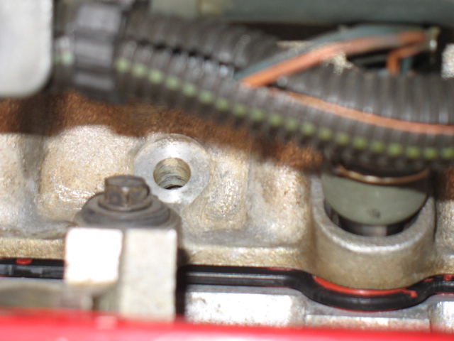

    92 Z34 lower intake gasket question.
    I put my lower intake back on and noticed there is a hole that I'm figuring a bolt goes in. I was very carefull to lable and put bolts in a bag when removing intake. Now I'm not sure if there is suppose to be a bolt there or not. Heres' a few pics. Thanks.
  • walterdude
    Destroyer Of ALL THINGS!!
    • Feb 2006
    • 265
    Those look like the bolt holes (another is hidden under the UIM) for installing the LIM. A bolt goes thru the holes into threaded holes in the block and when tightened pull the LIM into place,,, so it's easier to line up the LIM holddown bolts. If I recall a couple of UIM bolts with sockets for spacers worked for mee!
    After the LIM is installed the bolts come out.
    In your case,,, if everything is lined up and nothing is leaking you should be set...
    Hope that helps,,,,
    Tom.............

      Yep, those are called alignment bolt holes. There is two of them and they help set the intake for a perfect seal. they cost me $13 a piece from gm. They are very important.

            You don't need them in the car. They are just for installation.
            If you want the specs, I can give them to you. You can buy the bolts and washers at any parts store.
