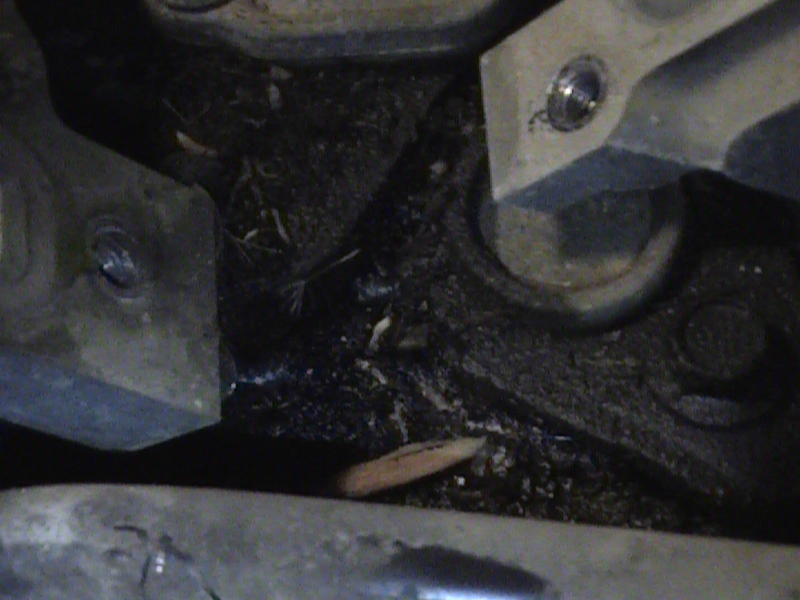

            Well I have the plenum and intake pulled and I can def see how bad it was leaking oil...
            Problem is just getting to it..I read the write up on replacing without removing the head and I cant seem to get it up far enough due to the head too even manage to slip the oring over..
            Also read through how some people have cut at an angle on the tab to get better access..but have been told that will compromise the integrity of the seal and cause coolent leakage.
            So I dont know..This is the first time I have ever messed with a dohc engine and I am hesitant on removing the heads cause of what all is involved..
            I know it would be best as they are probably sitting on the original gaskets. I am just worried about messing shit up due to not knowing what in the hell I am doing..
            I have seen all the different write ups.. maybe I can get a buddy over here to help.I would put it in the shop but damn the parts and gaskets alone are a pretty steep price, I would hate to see what labor would be!
            I also just found out today that there is a back plug that is stripped out...so the damn head needs to come off to fix that!

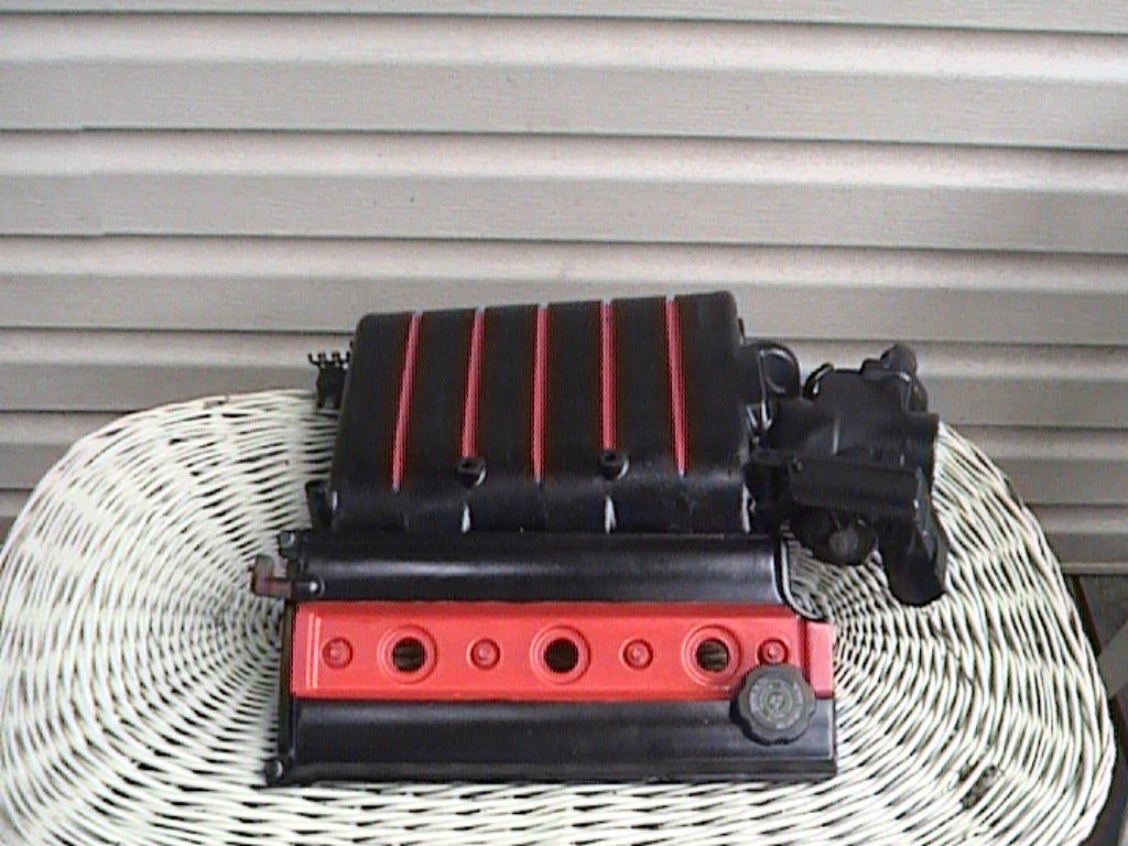

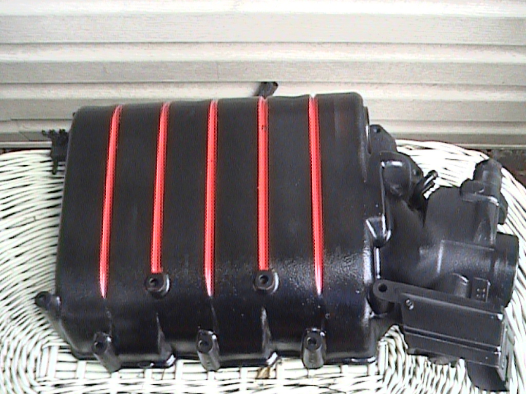

            I have attached some pics..one of the famous problem, and some of what boredome and extra cans of engine enamel lead to.
