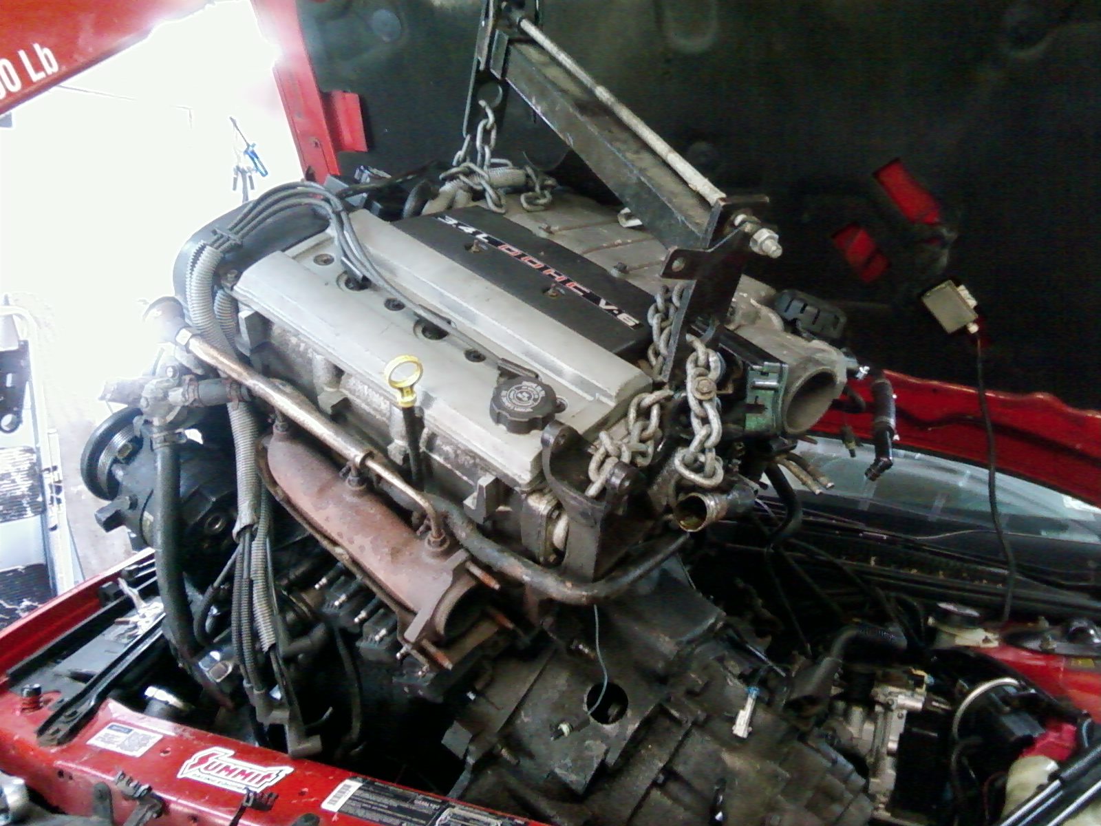

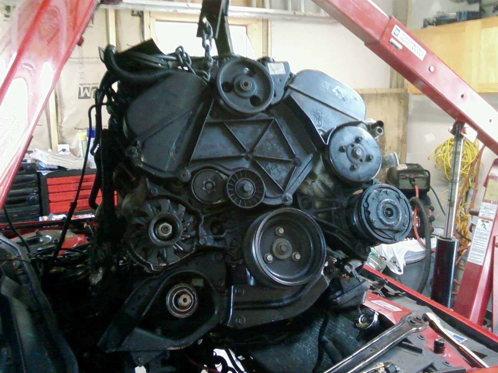

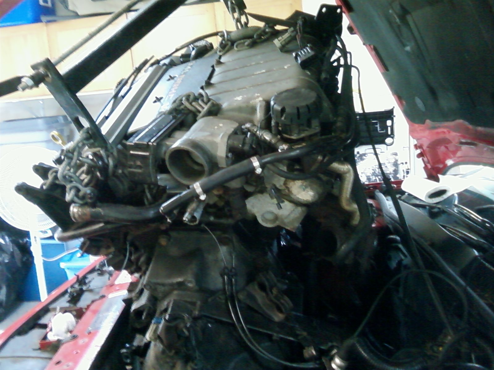

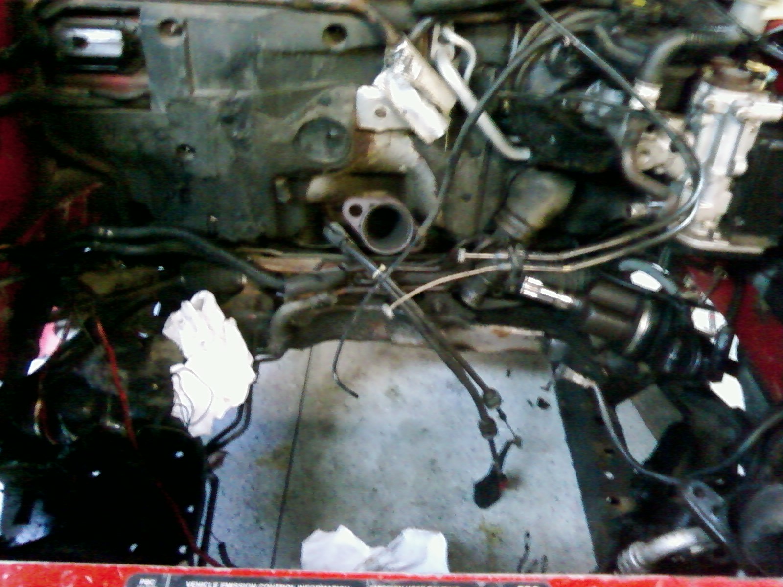

          Its out!!!
          It came out the top. Just had to give it some angle and the best thing was I needed no help to do it. It was very easy.....all things considering....THANKS JON as always. Make sure you keep feeding that cat so that its head gets even bigger!!!!i'll try to get some pics of the damage.
          BTW My a/c compressor was attached and I cleared the ABS Modulator. I un seated the axles, I didnt even have to pull then out at all. Compared to the auto I dont have the break open the bell housing nor do have to undo a torque converter.. that saves some time right there...

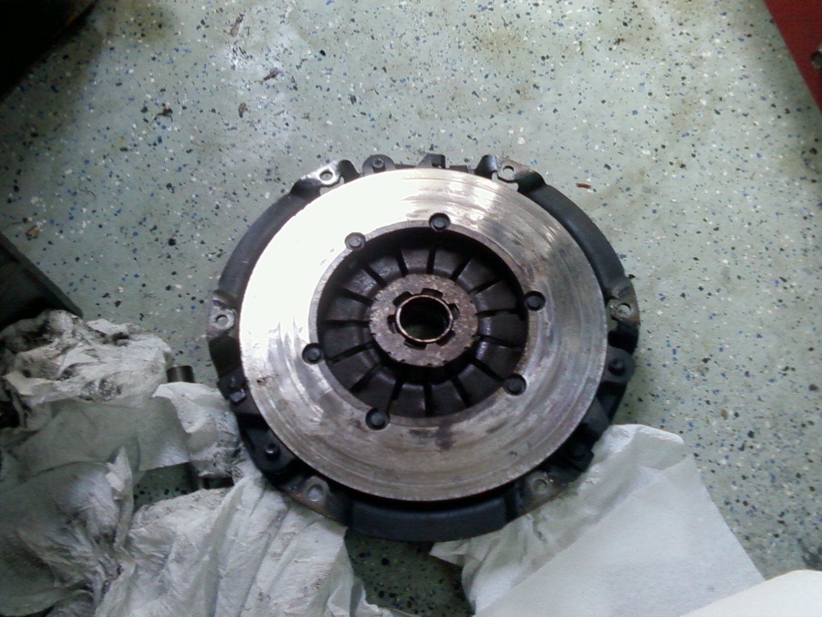

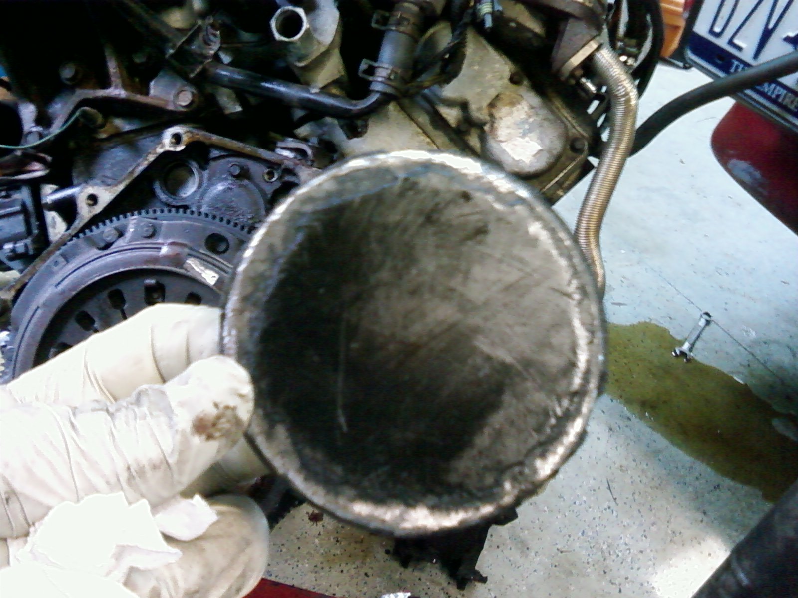

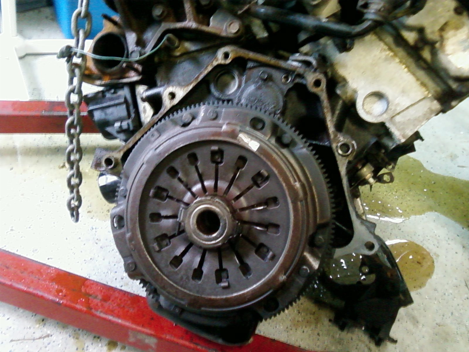

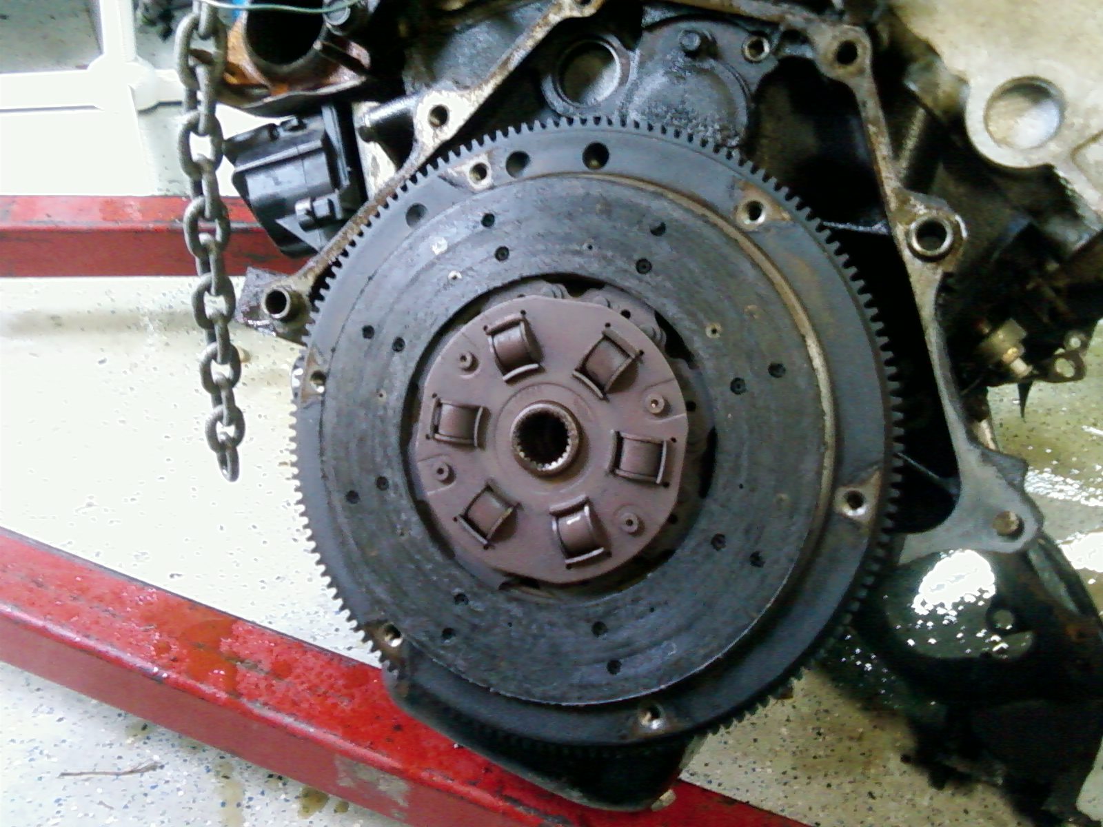

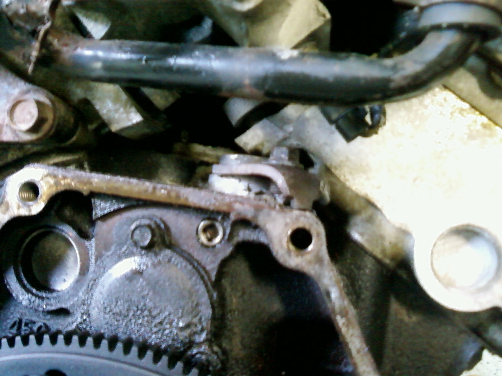

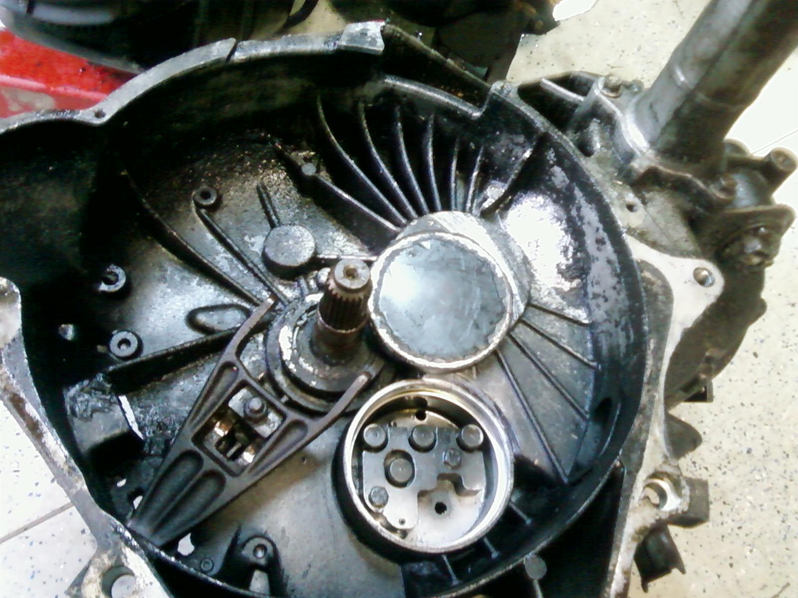

            Ok an access cover fell off and was grinding into the pressure plate. So that was my huge leak......the input shaft seal looks old but seems to get holding...I will change it regardless and shore up that cover with some engine paint an grey RTV... Clutch is worn, flywheel is pretty damn good..pressure plate the same. Throw out bearing is kinda rough. trans mount is partialy torn...Would really like to get another one of these if anyone has one.

                  WHAT A MESS! Well that would explain all your oil leaks.......your pan is probably fine haha. what holds that cover on there? A press fit? Time to get out the JB weld.......
                  You got to that clutch just in time....that thing is toast I can see the worn rivets from here.....anymore wear on that thing and your flywheel would be screaming uncle. Good luck buddy, I might be able to come down to say hi this weekend.....if my turbo is back from the builder.

                          Detent cover painted silver and JB Welded
