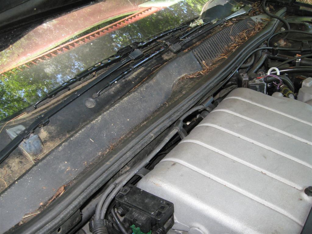

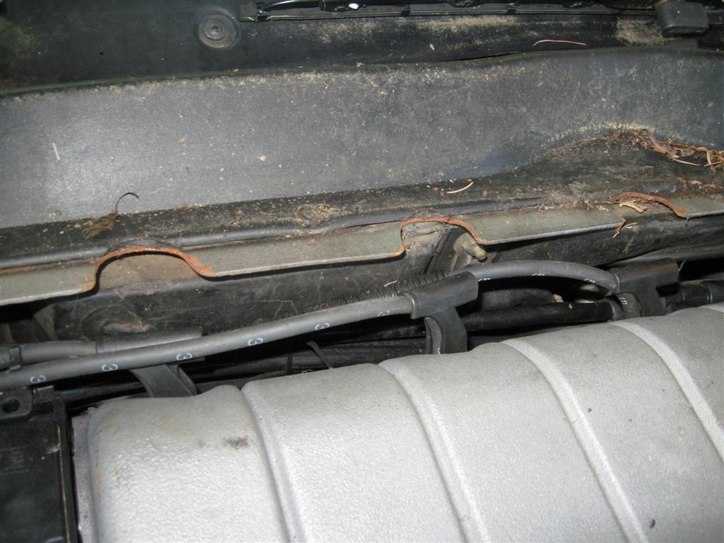

      As for the plugs,,, I used to pull the DogBone mount and use a small come-along to rotate the engine forward. Later I got wise and used a hole-saw to make cutouts. I can do the plugs in about 5 minutes,,, literally....

            3.4 tDC to be fair, other than the timing belt, alternator and any thing else in the lower rear or the motor, the rest of it is straight forward with the spark plugs being rather easy. the Body does get in the way of the rears but there are ways to get around it, as shown.
                Works for MeE!!!
                Tom
                I used the same idea as yours except i didnt cut,I just bend the the steel up and just bend it back after doin the rear plugs.
                  I used to live in a park where my drive was sloped, so I parked with the nose to the road (down) and pulled the dogbone with the car in gear, which would rotate it for me. Once plugs were done I used a wheel chock, popped it in neutral, put the dogbone back and was done. Nick, the previous owner of the 92 had epoxied the edges of the defrost vent and other portions of the dash down, so mine haven't peeled up on that car yet.

                        Don't know how much the Grand Prix firewall area is different, but I could do mine just by taking off the weather stripping and nothing else. The lip the weather stripping goes on is not bent neither.
