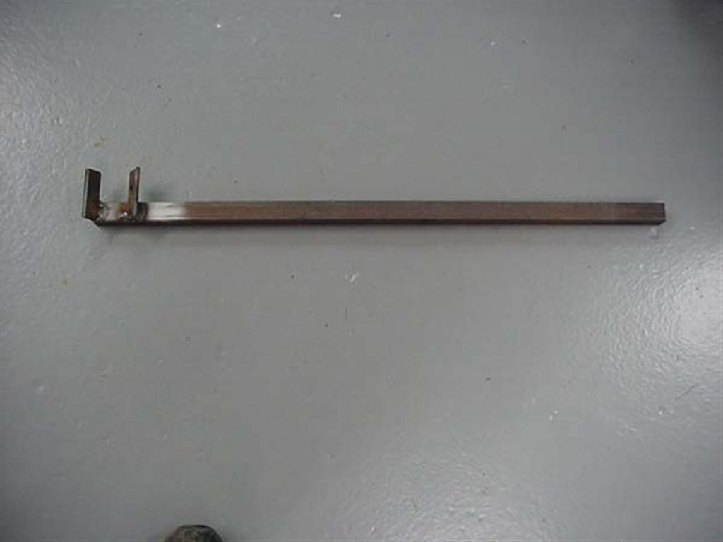

    Well, I'd say you're lucky just the socket broke.... You NEED a cam-sprocket holding tool before you start crankin on any wrenches... The timing tool is NOT designed for that and can strip either the bolt (if you're lucky) or the threads in the cam carrier. If the tool is made from key-stock the tool can also bend. Attached is a jpg of a home-made cam-sprocket holding tool, easy to make. Once ya gots that position it so it rests against something solid and try it with a GOOD socket, breaker bar and maybe a pipe over that if needed... If you have air wrenches maybe that would help?? Soak it with PB Blaster....... But first you have to be able hold that sprocket..... Once you do that you should be able to loosen the bolt....
    Hope this helps,,,
    Tom

      Yea thanks for the help. For now I just decided to raplace the belt and its components and I will go back later when I have all the tools I need and actually time it. Since its a 93 how do I go about pulling the rear cam sprockets once I remove the bolts. Is there a puller that will fit inbetween the sprockets and the passenger strut tower?
