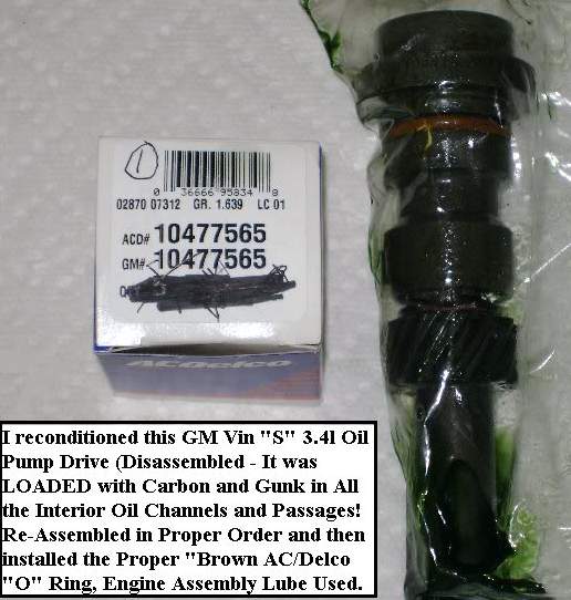

    oil pump drive seal.
          X2^...
          The attached image shows the re-built and re-conditioned Oil Pump Drive (lathered up in Federal Mogul Engine Assembly Lube) , the New Brown PTFE replacement "O" Ring for the infamous "Leaky Black "O" Ring... and the end panel of the AC/Delco Box showing that New "O" Ring's Part Number(s)...
