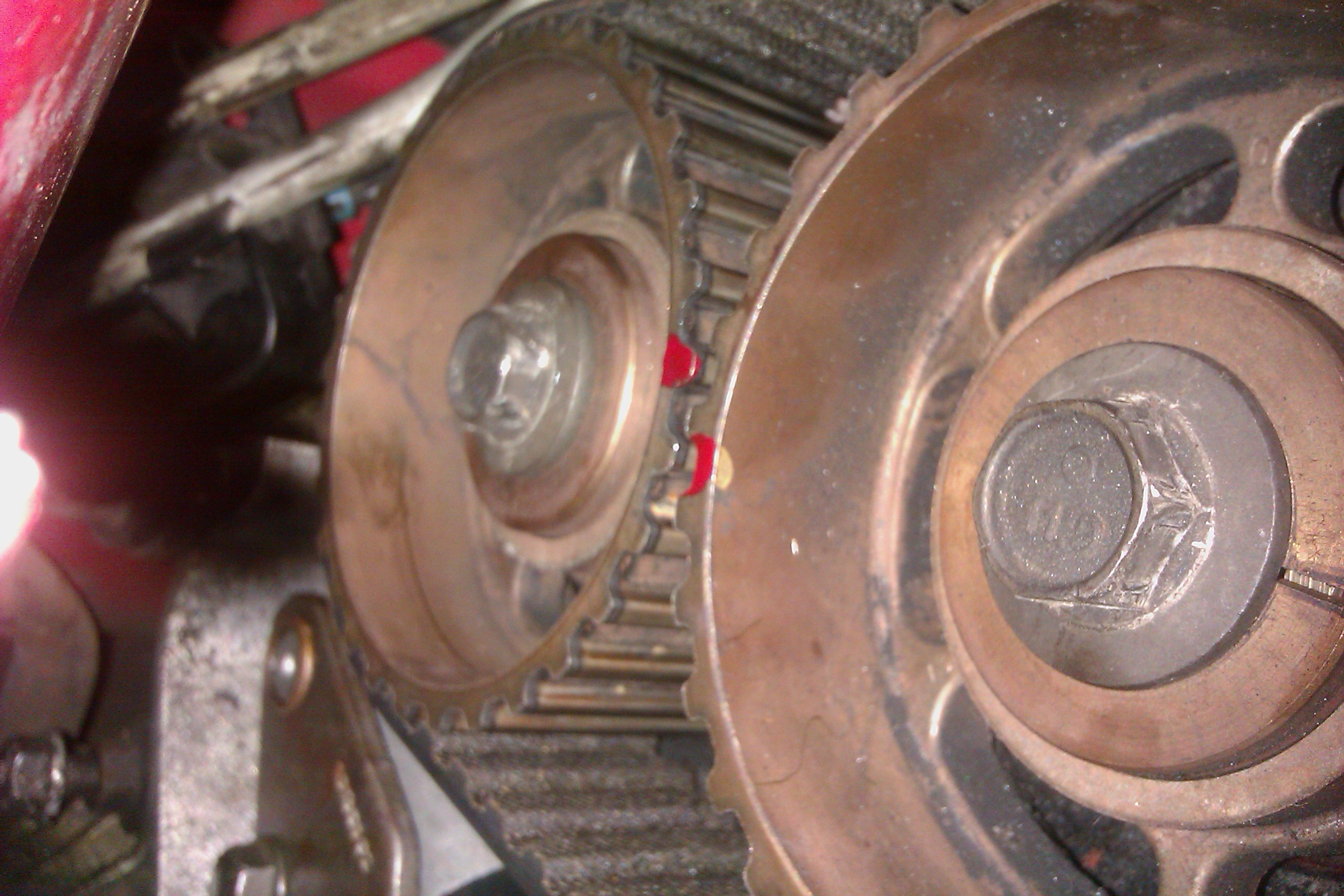

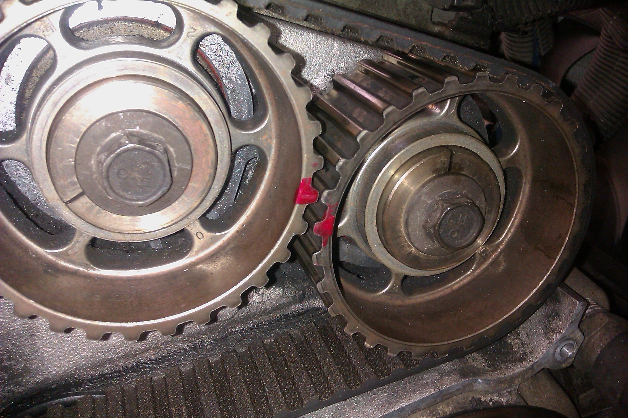

                            Right side cams (re-painted factory marks) aligned per manual

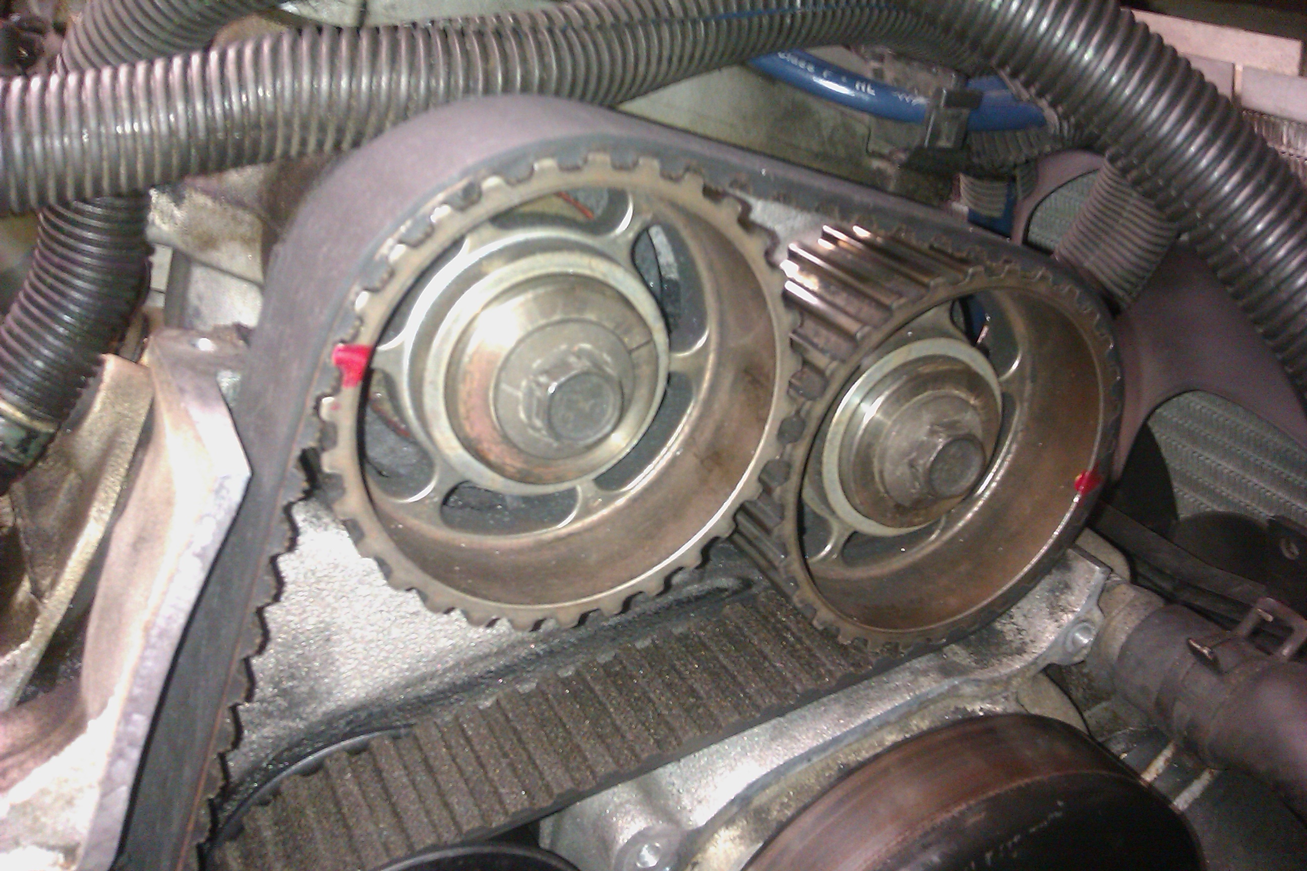

                            Left side cams (re-painted factory marks) aligned per manual

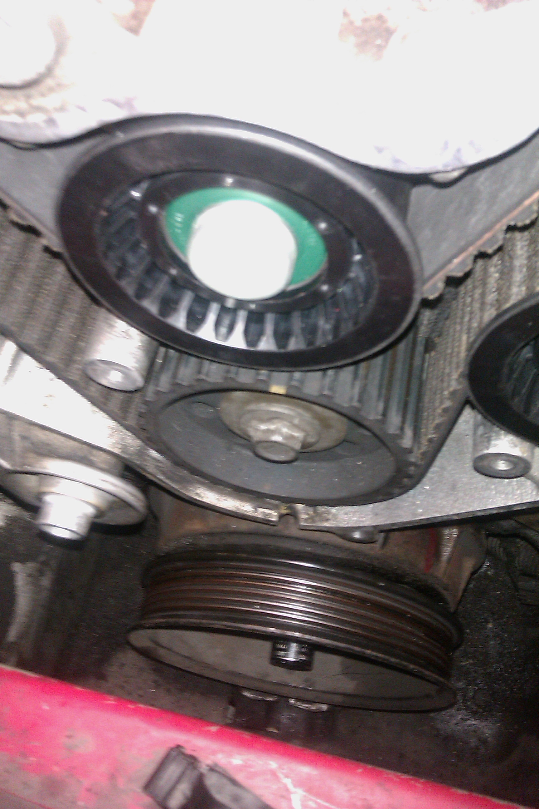

                            Original Factory intermediate sproket mark vertical with notc mark at bottom of engine

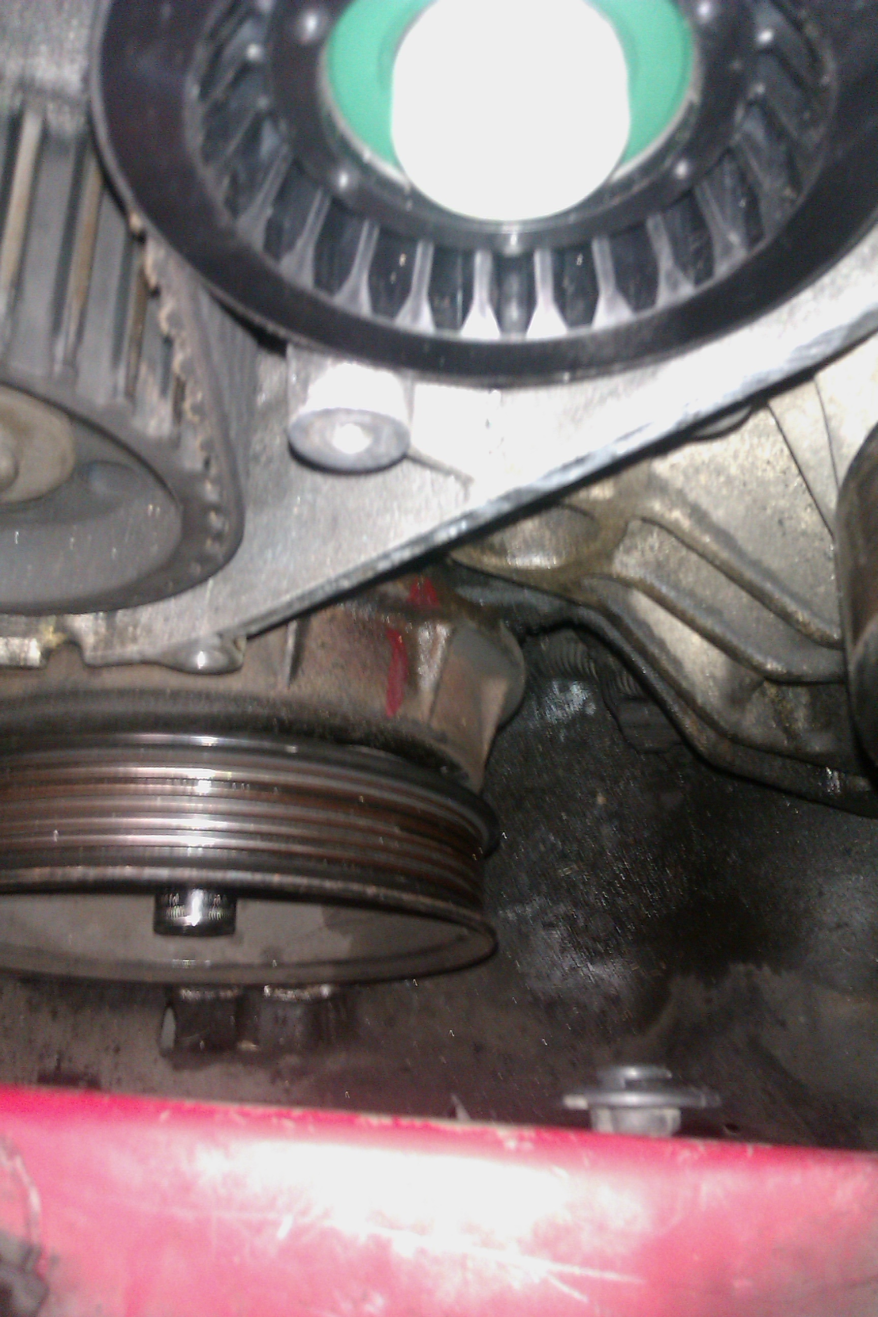

                            "two O'clock Factory mark" re-painted red on crankshaft
                            Now, after rotating the crankshaft 360"0" you can see that my "two O'clock" factory mark is about "one 30" while the intermediate sproket mark aligns well with the lower notch in the engine......and that difference shows up in the cam pics

                            Right hand cams after a 360"0" rotation of the crankshaft
                            Left hand cams after a 60"0" rotation of the crankshaft
                            I know that they are off and that is why I can hear the slight tap tap tap....So I am gonna try to tweak them some more.... Like I said before this is my toy car and I dont plan on drag racing it or nothing but hey...I want it to be dependable and I want to be confident in the car enough to put the pedal to the floor every once in a while. Engine builder I am not...Afraid to get my hands dirty....nope...saving $1100 at the GM place to do this will make me smile bigger than you can imagine!
