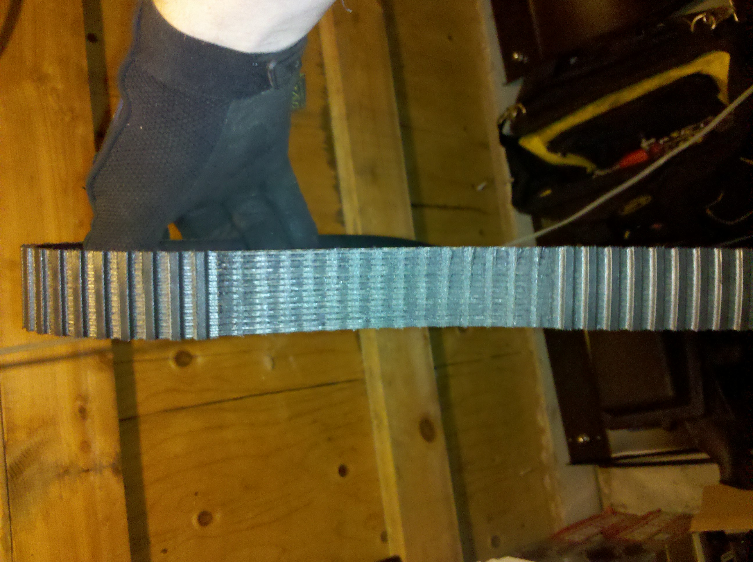

          Found the problem..
          Timing belt's missing a few teeth....

          • 1988GTU
            LB62LHObbqftmfw
            • Nov 2005
            • 2475
            That'll do it!
              Sort of like the 91, except it shredded through the belt backing lengthwise some as well. At least you found it and it's a relatively simple fix
              • crazyd
                • Mar 2007
                • 100
                Yeah, I finished it up and got it running again last night. There didn't seem to be anything wrong with the actuator, but I replaced it anyway. It's no wonder this motor got such a bad reputation, if I'd had to pay for another timing belt repair (this is my second failure in 2 years) i'd really be pissed...
