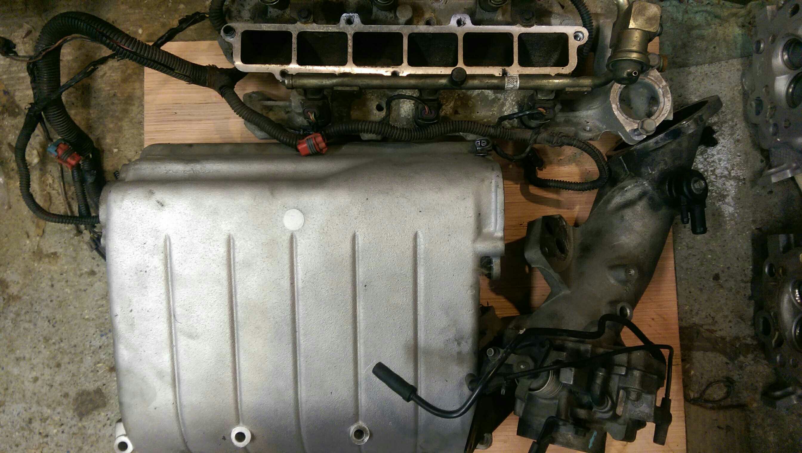

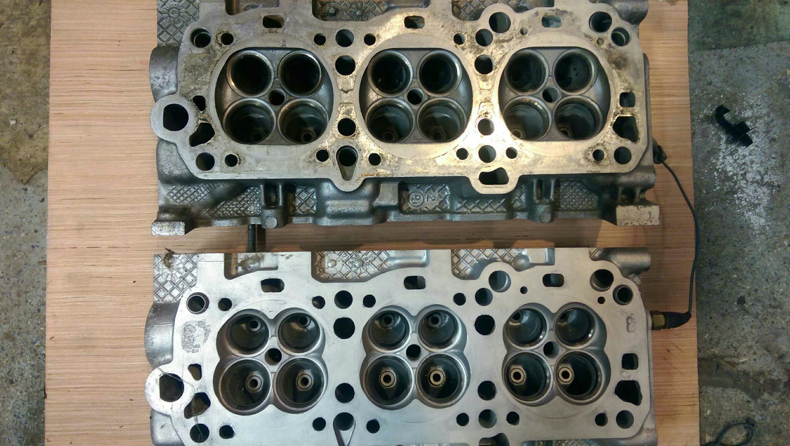

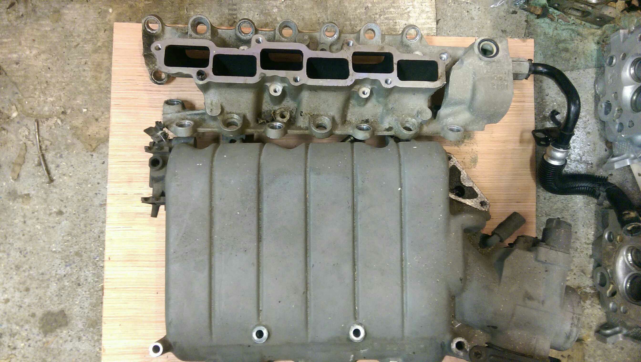

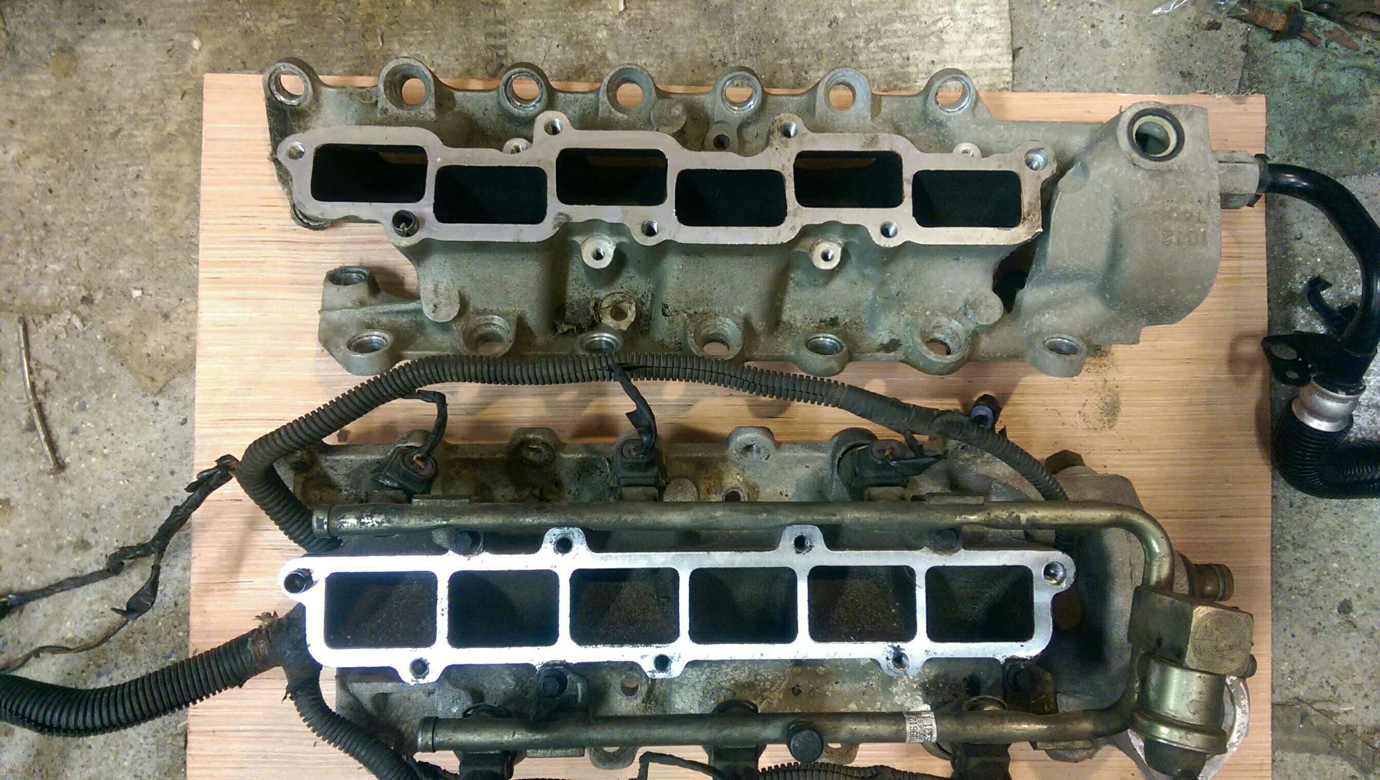

                  You do not need to swap heads and cams to compliment the 96/7 intake. The heads on the 96/7 heads have large pill shaped exhaust ports and clover shaped combustion chambers vs the d port style on the 91-95, but any LIM will bolt to any head (styles of LIM and UIM don't interchange between styles, though; 91-95 LIM must be used with 91-95 UIM).
                  I've no idea what order this thing will post those pics but in the ones that have both year model shown, the earlier 91-95 is on top and 96/97 on bottom. Hopefully 4MP from my phone is sufficient enough of resolution to help.
                  If you go from the earlier style I take to the later, there is a write-up on this site detailing it. Besides the obvious LIM and UIM, you also need the later throttle cable (longer than the earlier style), brake booster hose (booster port is in a different area), either cut your rear plug wire boot covers down or grab a set of later plug wires because although it's not noticeable without any sort of reference, the 96/7 UIM is longer than the 91-95 (i was going to swap over a set of front ones on my Magnecor wires vs spending what, ~$200 on a new set?), you could leave your ICM where it's at or grab the bracket and move it behind the PS pump where it won't be directly under the exhaust mani. I'm sure there are a few other things I'm missing as well, so read through the write-up.

                  91-95 (top) vs 96/7 combustion chambers
                  91-95 (top) vs 96/7 LIM
                  91-95 LIM & UIM
                  96/7 LIM, UIM & intake arm

                        The only other difference other than what I posted was the 94+ engines had an intake cam sensor on the front bank, and I think the oil cooler was discontinued around 93 or 94. Also if you have a 91-93 engine and it has air injection tubes in the exhaust manifolds, it is an engine from a manual car and has the 210hp engine vs 200hp in the auto. I also believe it was determined the small CR boost in the 96/7 engines was from the pistons, not the clover combustion chambers on the later heads.
