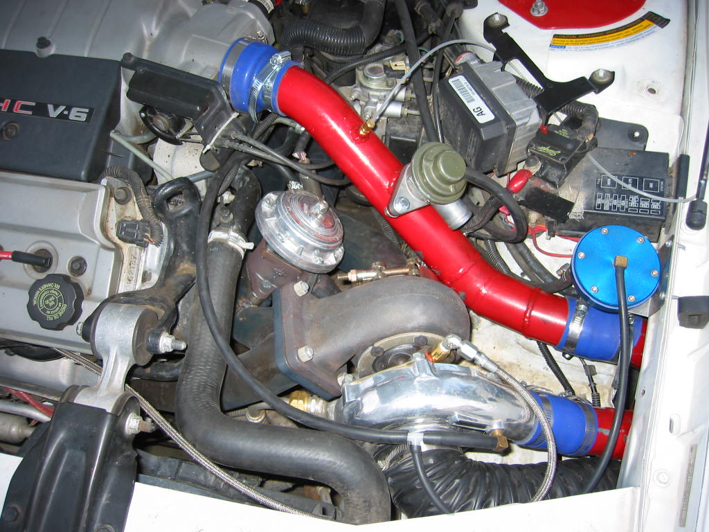

            my old TGP had a big T25 (oxymoron?) turbo on the 3.1MPFI motor and i could power brake it and have ~8-9psi before i even left the line and peaked 10psi. so if you use the right turbo setup you can gain power everywhere. On a DOHC i would say a big T3/T4 would be the smallest i would go. it will give you better low/mid range power. my T4 would be great at sea level but its laggy at 5000ft altitude. no problems in over a year and 30K miles boosted...
            Custom x-over/downpipe and charge pipes and your boosted (for the most part) like so... (my car)

                  There are a few of us with supercharged or turbocharged 3.4's. It's not easy or cheap. At a minimum for a VERY basic turbo setup you need:
                  Turbo, wagtegate, all intake and exhaust piping, silicone couplers, hose clamps, a new air filter, oil feed and return lines, a downpipe, a wastegate dump tube, lots of little hoses and fittings, a FMU, and a various gaskets and other parts that I'm forgetting.

                            Here's my old setup with the FMU and smaller piping.
                            325 whp 350 lb-ft
