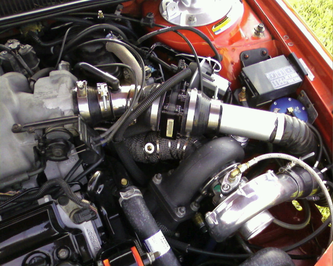

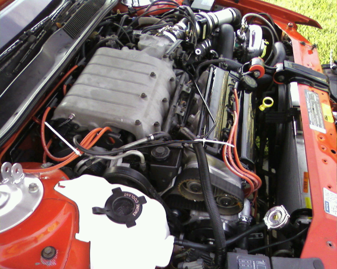

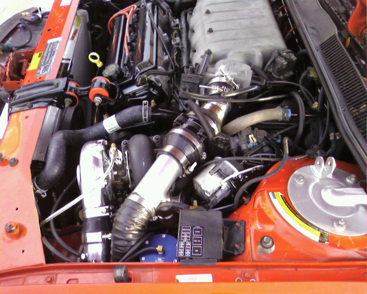

                      I took the charge pipe off and drilled 3 holes. bov,wg and fmu. Now I used a grommet and a plastic fitting. It is pretty loose thought. Now when I was driving it I noticed that the car drives it self at 1500 rpm. Basically I dont have to touch the gas. Also I get no A/F reading when this happens. How touchy are those lines. I will post a pic. give me a sec

                                You are still referancing boost for your BOV? You need to hook your BOV to the plenum.
                                If those fittings are loose, and you have a MAF ECM, then you have a vac leak.
                                Wait, it looks like a you do have a MAF, and it's after the turbo, it needs to be before the turbo. The MAF shouldn't see boost.
