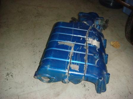

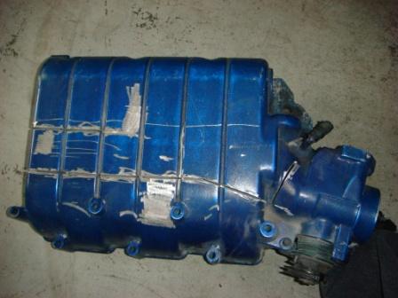

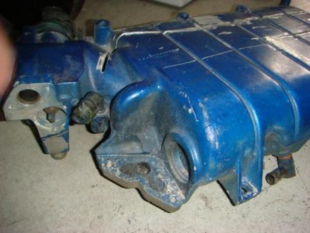

    Hey I been working on cutting up a 93 intake manifold to make a short runner intake so that I can go a little faster . Just had a couple questions before I move on. What do I do with the sensors (MAP and EGR and Brake Booster Line?) that will be cut off? Feel free to criticize and voice your thoughts.

    What you need to do if throw that fucking thing in the garbage, actually you can get like 8-10 bucks at a recycling yard. If you wanna make a direct port manny you need to have access to a machine shop. You need to have direct port runners going into the heads, or you can make it fit the lower intake manifold but that wont give you maximum power. Cutting up a stock manifold is going to be a lot of work and not much improvment over stock. As far as the sensors. if you get teh new manny made just have them make a hole in the side for the mad sensor with two nipples for vacuum. The egr you can probably delete if you get a chip, seeing as you are using a 93 manny I am guessing that you have a 93? As far as the brake booster line, justa add another vacuum source.

        it think it is the color and scrape marks on the manifold that are making us not take you seriously.... building a new intake is more then just cutting one up and indiscrimently welding it back together.
        yes short runers tend to give more top end HP but at the cost of low end tq. a lot of calculations should be made to make sure that your new intake manifold will make the max HP where you need it.... IE there is no point on making a new mani that has its peak at 8000 or 10,000 rpm! our cars wont get there! we are not rotarys nor have VeEeeTeCK! careful adjust ment of lenght, volume, flow angles, are all needed to plan out a viable new intake. the questions you are asking are the easyest part of making a new intake manifold. Honestly without a means of tuning the car building a new intake manifold is a step in the wrong direction.

            anywho, i cannot help you with egr other than suggesting deleting it. as far the other other situation goes, i would drill and tap 3 holes in the intake(when you finish with it of course).
            you should be able to remove your brake booster fitting from the stock intake, drill tap and re-insert it in about the same spot.
            id drill and tap 2 more holes for 3/8 vacuum fittings. one of the fittings will supply vacuum to the pcv and the other fitting should go to a vacuum block where you attach everything else to.
