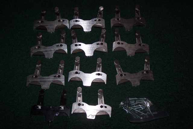

                        it may take a while b/c demand for them is not high at the moment. The one on the bottom left was the original. It was an all aluminum construction, when i chose to re-do them i had the arms made of steel b/c the aluminum would get eaten up after a few uses.
                        I chose not to put the stickers on them b/c of cost and it was said and proved that using the arms to time would become inaccurate after a few degrees. Therefore you must keep the arms flat where they are accurate and time by the crank. There were 0 marks machined into them for this purpose.
