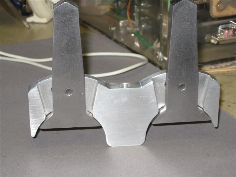

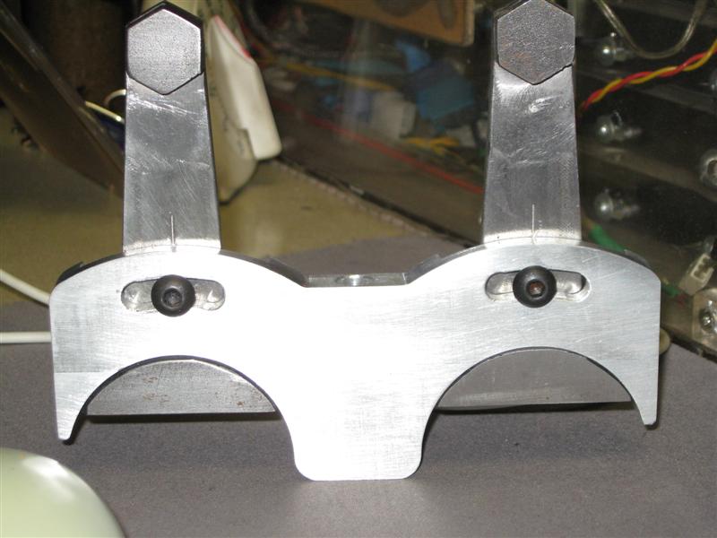

            I'd say the puller on the top right is for pulling the cam sprockets. You don't mention year... 91-93 you have to pull the cam sprockets to release the lock rings. You asked about the 6-6 timing... Those tools you have will time it to stock settings.. To do different timing you need tools like the attached pictures and a degree wheel (there's a link to download that somewhere on the site,, possibly under "Old Articles")...
            The adjustable tools were a group buy.... There was the start of another thread to make another batch,,, think that died out tho.... Do a search for DOHC Timing Tools and you should find it.... Maybe some interest would be sparked and enough people will commit to another run....
            Hope this helps,,,,
            Tom.........
            Hit up PhantomGreen,,, I believe his tool is the same as mine,,, he was in on the Group Buy when I bought mine. THAT would be the best/easiest way to get the tool...
            Here's the link to the degree wheel...
            http://60degreev6.com/forum/f72/diy-degree-wheel-t24979
