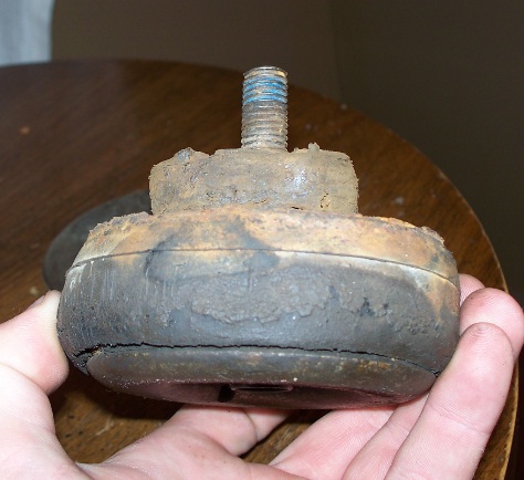

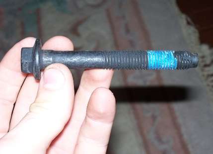

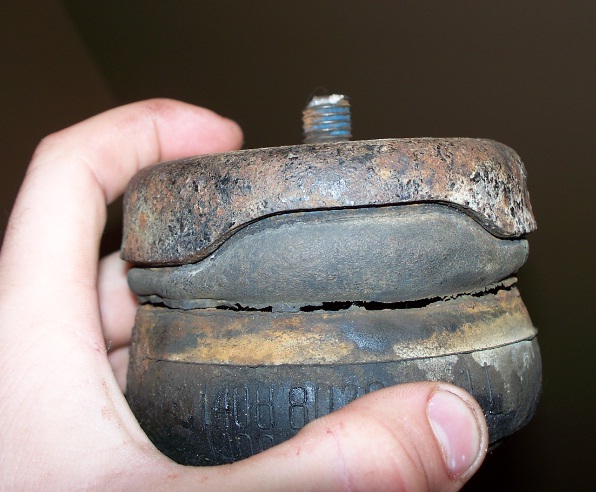

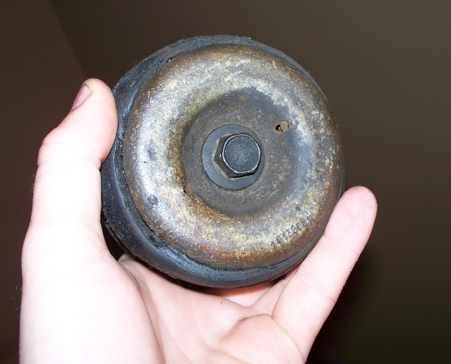

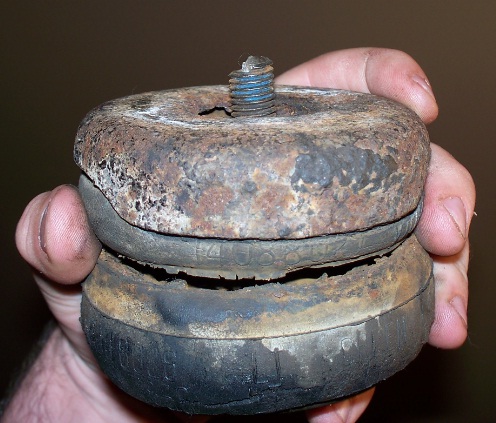

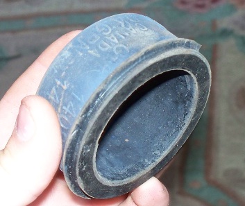

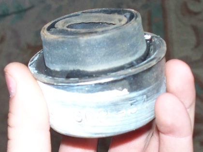

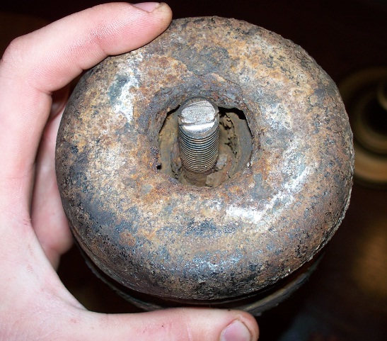

    Heres a few pics.
    Jake
      i imagine if they were sloppy enough, you could have gotten enough room for the momentum needed to snap the bolts

                  LOL ya my luck does suck, i mean look i sheared my subframe bolts lol ive never heard of that happening.

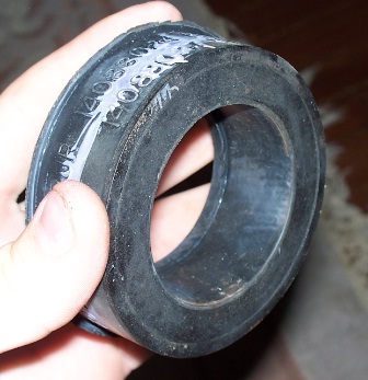

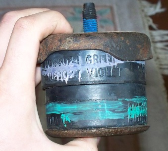

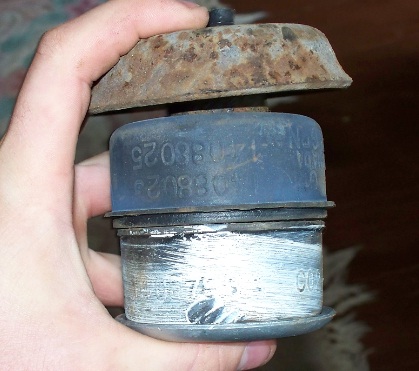

                  Anyways heres the part numbers for the new items:
                  FRONTS:
                  x2 Front Upper Steel Plate - 14087853
                  x2 Front Upper Bushing - 14088025
                  x2 Front Lower Bushing - 14088026
                  x2 Front Lower Steel Plate - 10139080
                  REARS:
                  x2 Rear Upper Steel Plate - Unknown At This Time
                  x2 Rear Upper Bushing - 14088027
                  x2 Rear Lower Bushing - 14088028
                  x2 Rear Lower Steel Plate - 10139081
                  NUTS & BOLTS (Same For Front And Rear)
                  x4 Subframe Bolts - 15677731
                  x4 Frame Lock Nuts - 10276401

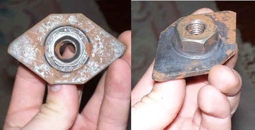

                    I ordered through gmpd.com, and yes these are genuine gm parts. Came to about $60 + ~$15 s&h. The only thing I didn't order was the steel plates since I figured there shouldn't be an issue in reusing the existing ones, they are not rusted or otherwise visibly damaged so I don't see the harm in reusing. I've had an occassional clunk/pop in my front end that I've had a heck of a time chasing down and the car is real jittery in reverse. In fact the subframe bushings are just about the only thing left that I haven't replaced.

                      Replaced mine today.... huge difference.
                      My occasional clunk is gone. It was definitely coming from the drivers side rear bushing which was basically destroyed. I didn't take pics but the rear bushings were both pretty bad, the fronts looked half decent.
