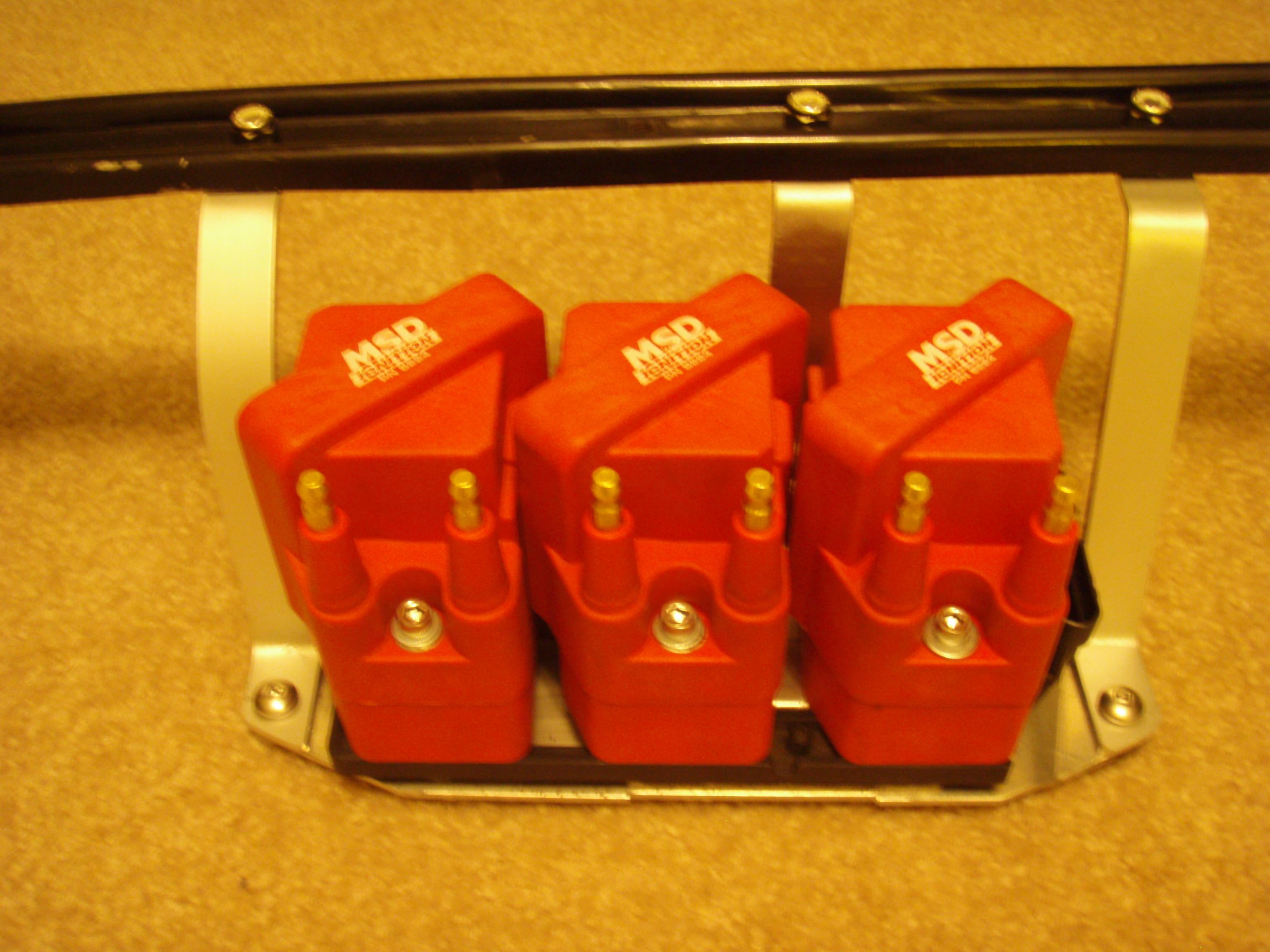

        I did what Hayes did on my car but used an early 90's honda accord. There weren't any preludes at the junkyard but I'm sure they're similar. The accord tank has all the hoses for remote mounting for the pass fender well and they are the perfect length to reach the rad neck. It even had a filler neck that slid right up behind the headlights.
        I mounted the ICM coil pack to the pass factory brace using aluminum flat iron. If you can find a 2.8l GM engine; the aluminum plate the ICM mounts to on that engine has shortened arms so no cutting is needed on on your 3.4 plate which has awkward length mounts.
