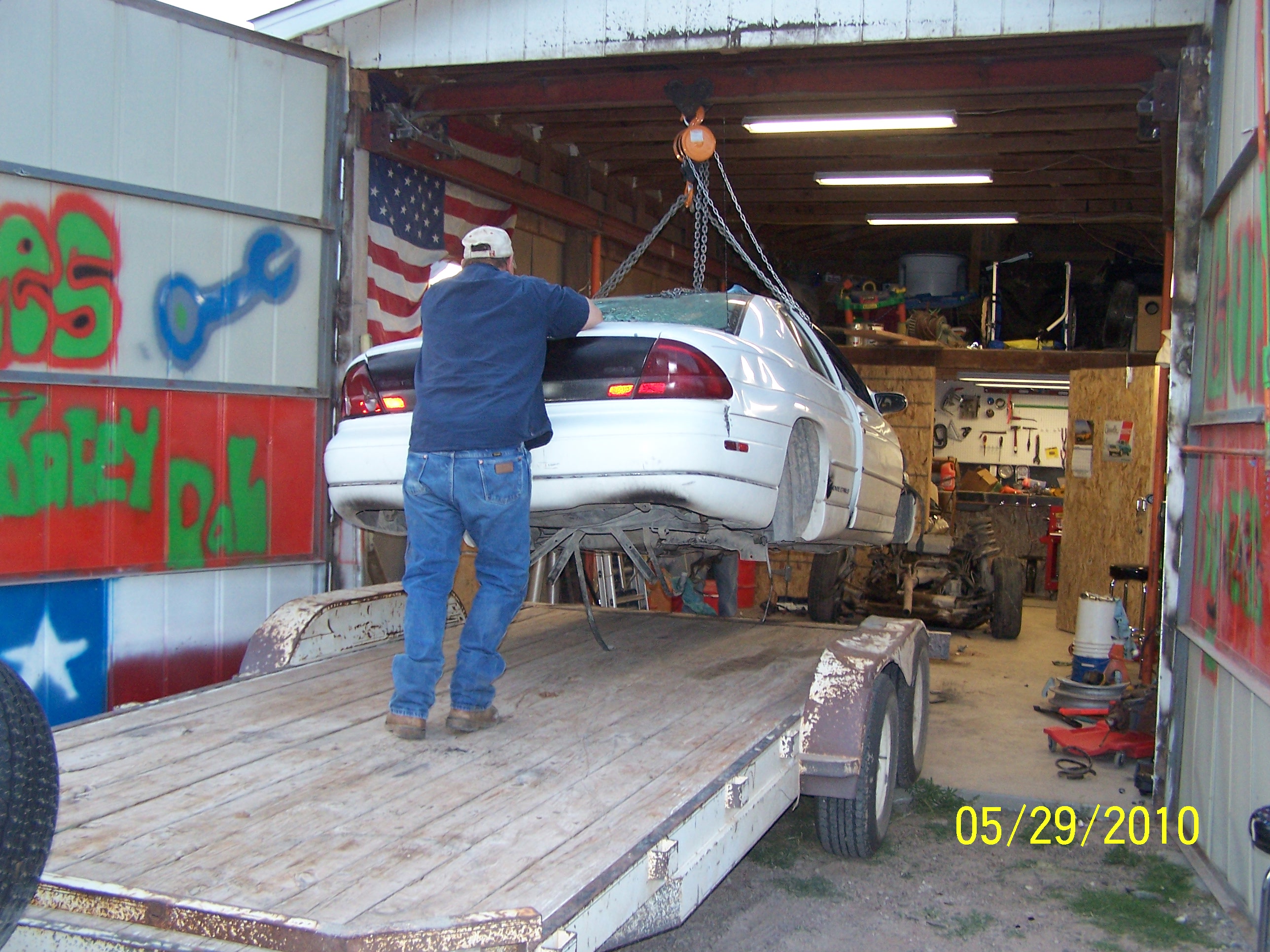

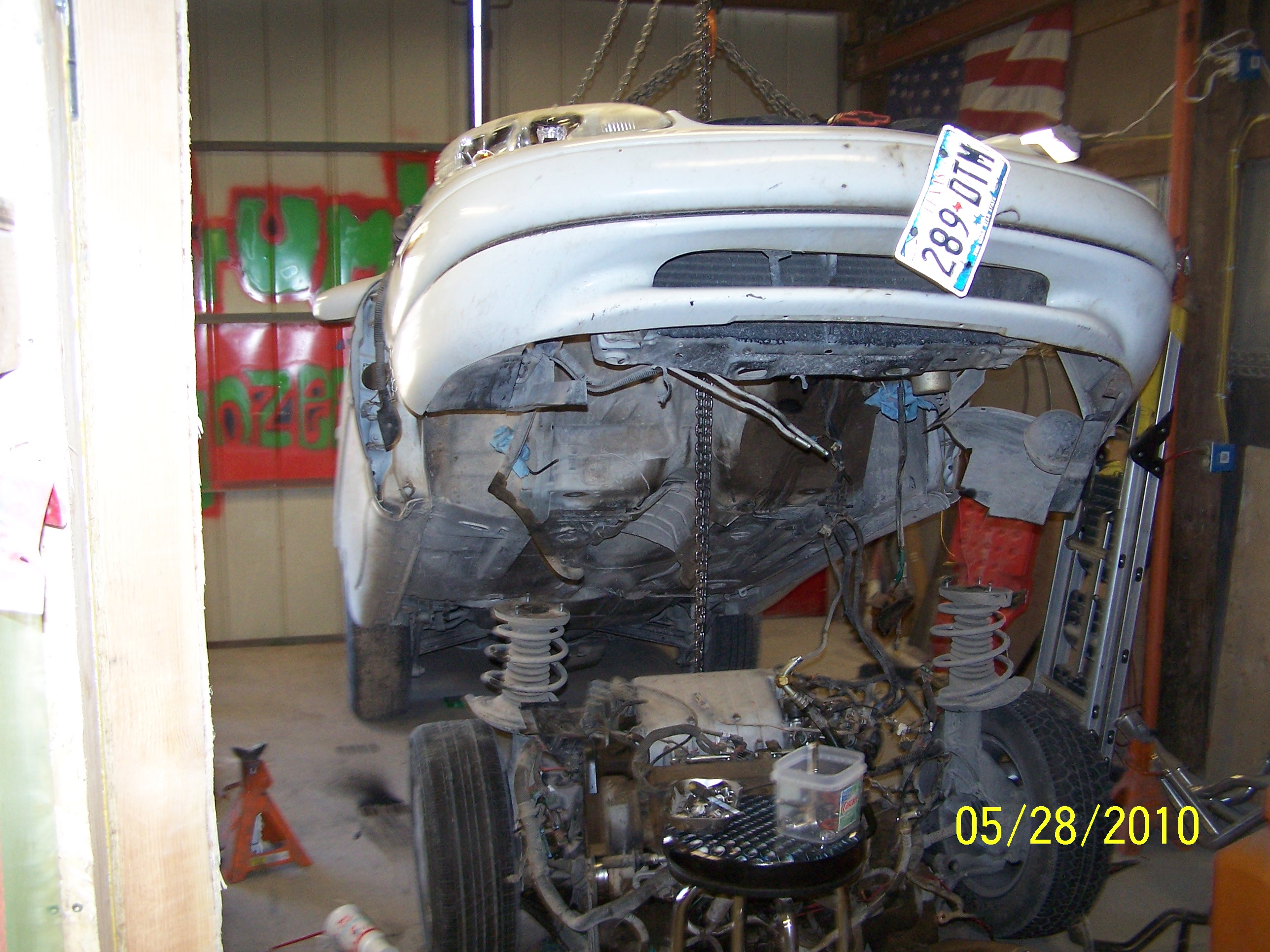

    let me start off by saying i don't want to offend any one here by the what i have done to a perfectly good 96 monte carlo Z! that being said i have the drive train out of and aw some running Z34 w/ LQ1 and a 4t60E tranny. the car was beat and raped by a previous owner and the interior and exterior were fubar, the motor and tranny were in perfect working order excpt for a few minor oil leeks.

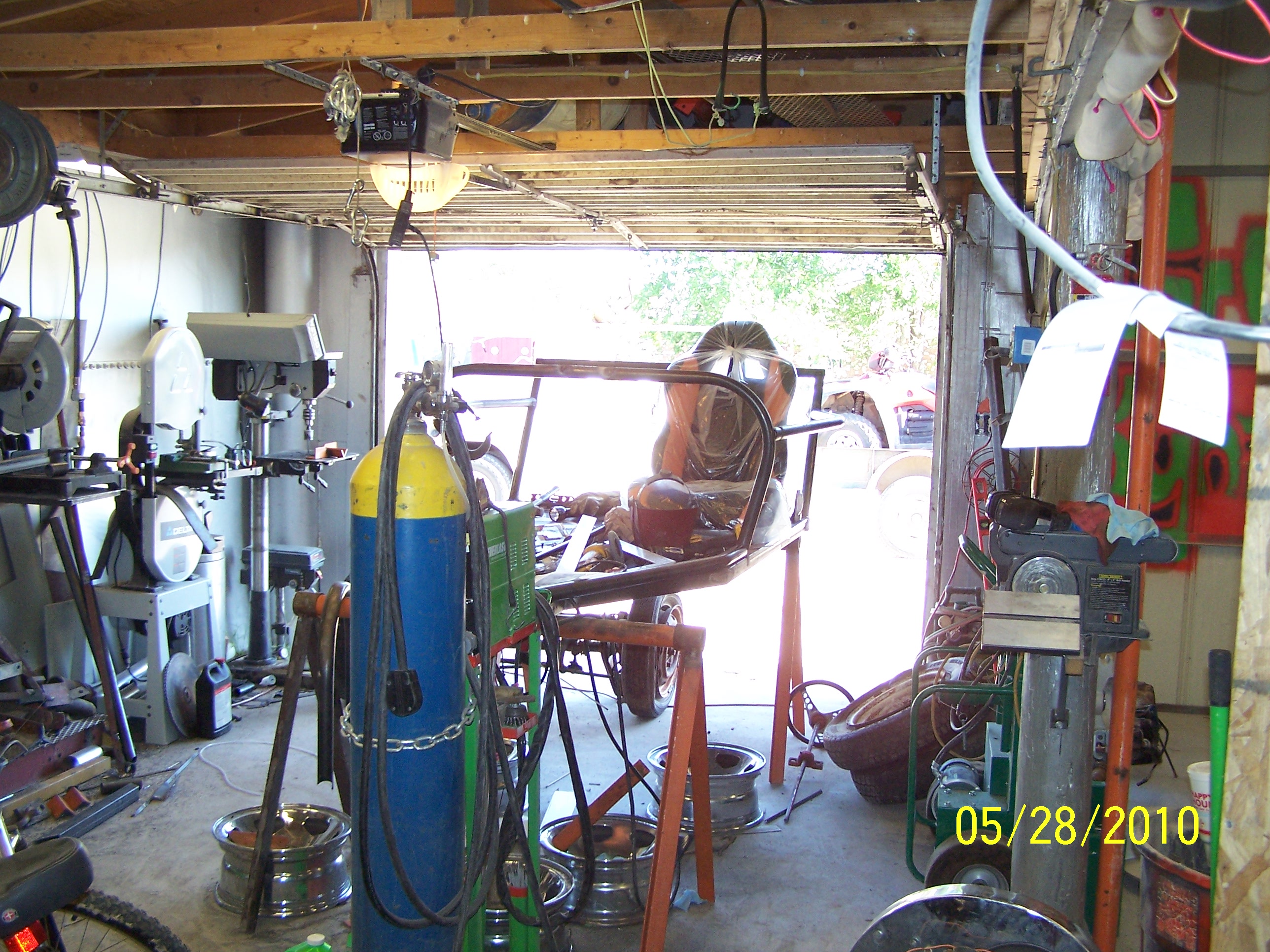

    i started a full custom sand rail project and wanted something different not like every one Else's 1600 vw . the 3.4 seems very peepy (almost like a hot rod) and i think it will be the perfect power plant for my rail.
    the thing i am most concerned with is the wiring. i saved all the harness in the engine compartment and as much of all the other harnesses that i could trying not to cut any thing not knowing what i would and wouldnt need

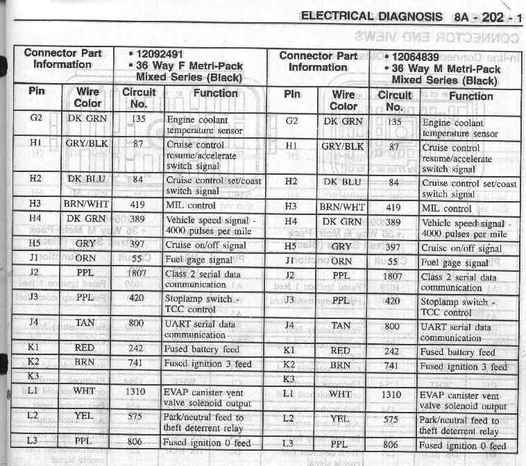

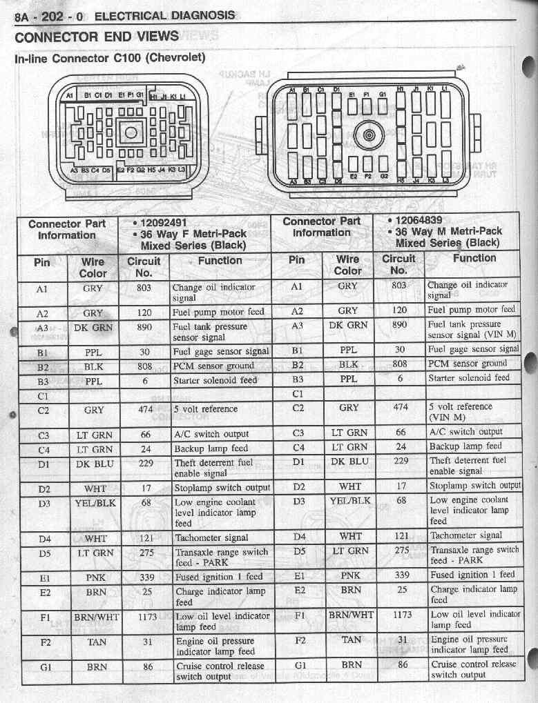

                I have a ton of wiring diagrams. I'm not sure I have any for the 96, but I do for the 96 w-bodies and 95 and 97 Z34. Between those, you should be able to figure out the 96 Z34. It's very close to the 97 Z34 wiring diagram. I've attached some of the ones I had already posted for the 97 Z34. If you want the rest, PM me with your e-mail and I'll send you everything I've collected.
                Tim
