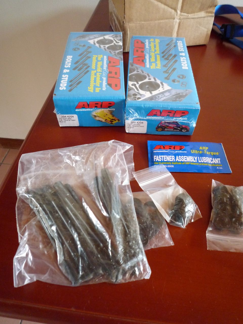

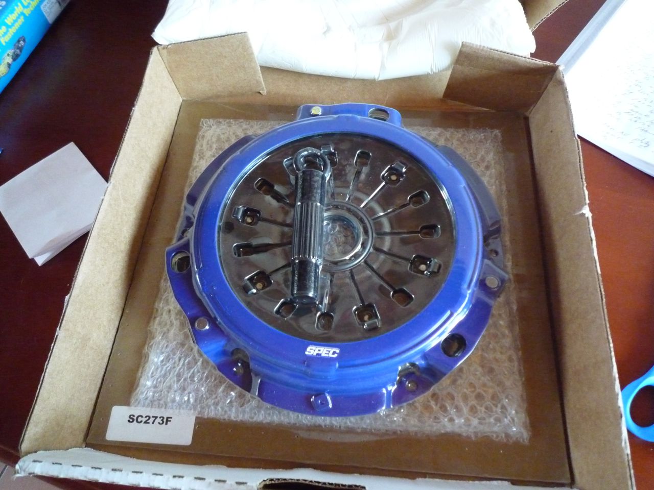

                          I'll report back on the SPEC after I get everything installed and running. Right now, the machine shop has it and the JY flywheel to get everything balanced. I'm missing the throwout/release bearing for the clutch. SPEC will be sending it once they get some new ones they have on order. Funnily enough, when I called them to report the missing parts today, someone else had called them about a Lumina clutch.
                          Tim
                          Pics attached of the new clutch and studs:

                            Lol that was me pissed about my clutch slipping. They said tho having my 6 puck re puked would only be like 70$. But i realy think i have oil getting in some how maybe from the trans input seal. Hey they put your pressure plat together correctly that's good.
