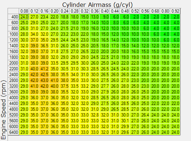

      High octane spark map from a 2004 Grand Am 3400. I know it isn't the DOHC as getting an OBD2 spark map for one isn't easy. I believe the 97 Monte Carlo had the DOHC but there are no maps for them that I can get. If you know of another vehicle 97+ that has the DOHC and is GM, obviously, let me know I might be able to pull that spark map for you.
      Maybe an OBD1 enthusiast here can help more. I'm restricted to 97+ due to HPT.
Name:	2004 GA HO Spark.jpg
      If anything, it is a starting point to reference. Good luck!

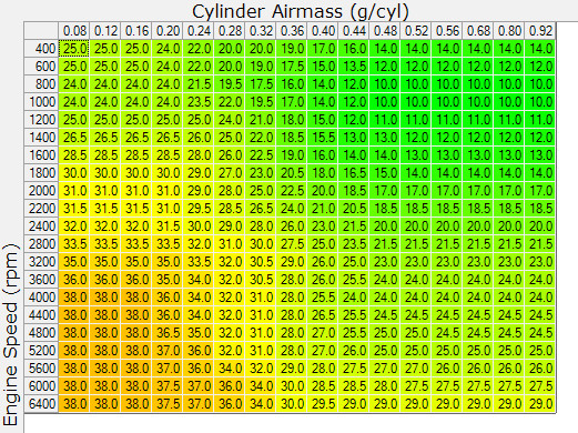

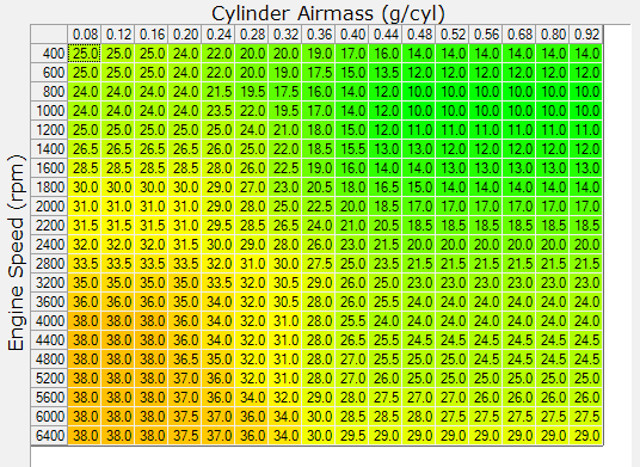

                60degreev6 has an LQ1 DOHC file from a 97 Monte Carlo. Lucky for you
                Here are the High and Low octane spark maps. If you need any other table from this file just let me know, I'll post it up for you.
                High Octane
Name:	1997 LQ1 DOHC HO Spark.jpg
                Low Octane
Name:	1997 LQ1 DOHC LO Spark.jpg
