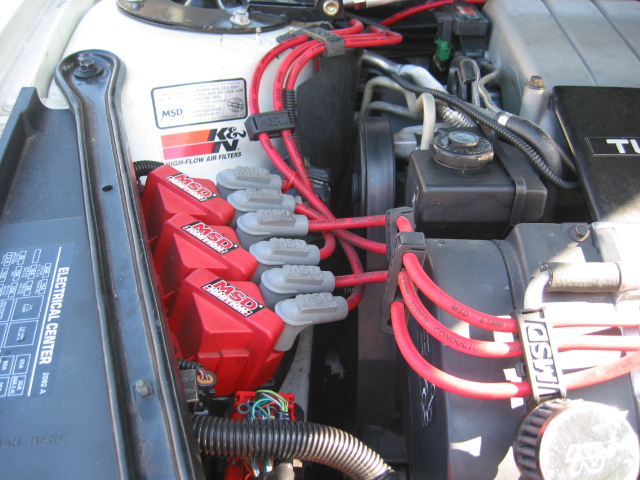

                    • HayesPerformance
                      • 783
                      I mounted mine on the Right side of the engine and got a samller coolant overflow tank and put it down low in the fender.

                      • tijuana_no
                        • Aug 2005
                        • 261
                        that looks cool,you think if you run a cold induction system there would be enough room to place the coils there,and how you thing that would look .i really love the way your oil breathers look,on a thread you gave the part you use ,can you do that again.
