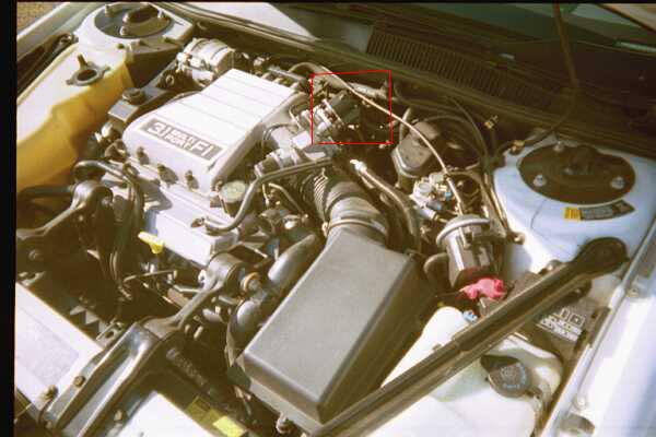

      Thanks for your reply. Well I'm grateful he still has it up as it was just the pictures I was looking for to see this part. Here is a picture. The part is in a red square. Thanks if you can tell me the correct name of it.

        That appears to be the EGR. Here is another picture for your comparison (bottom right):

          I better get back with them and let them show me again, because they said they cleaned it out, which made it work for a little while. It does and doesn't. I don't see how they could clean that out. Will that EGR cause a car to start sputtering and the check engine light to flash and then the car will die? It will start back up but it coughs and gags to get going again. Sometimes it goes fine then again you never know when you will be stranded under a red light.

            You can take off the EGR and clean out the passage into the intake manifold, as well as clean the valves at the bottom of the EGR. It can definitely cause the check engine light to come on. If the check engine light is on, take it to an auto parts store and have them read the codes. Come back with what the codes are and we can help diagnose it further from there.
