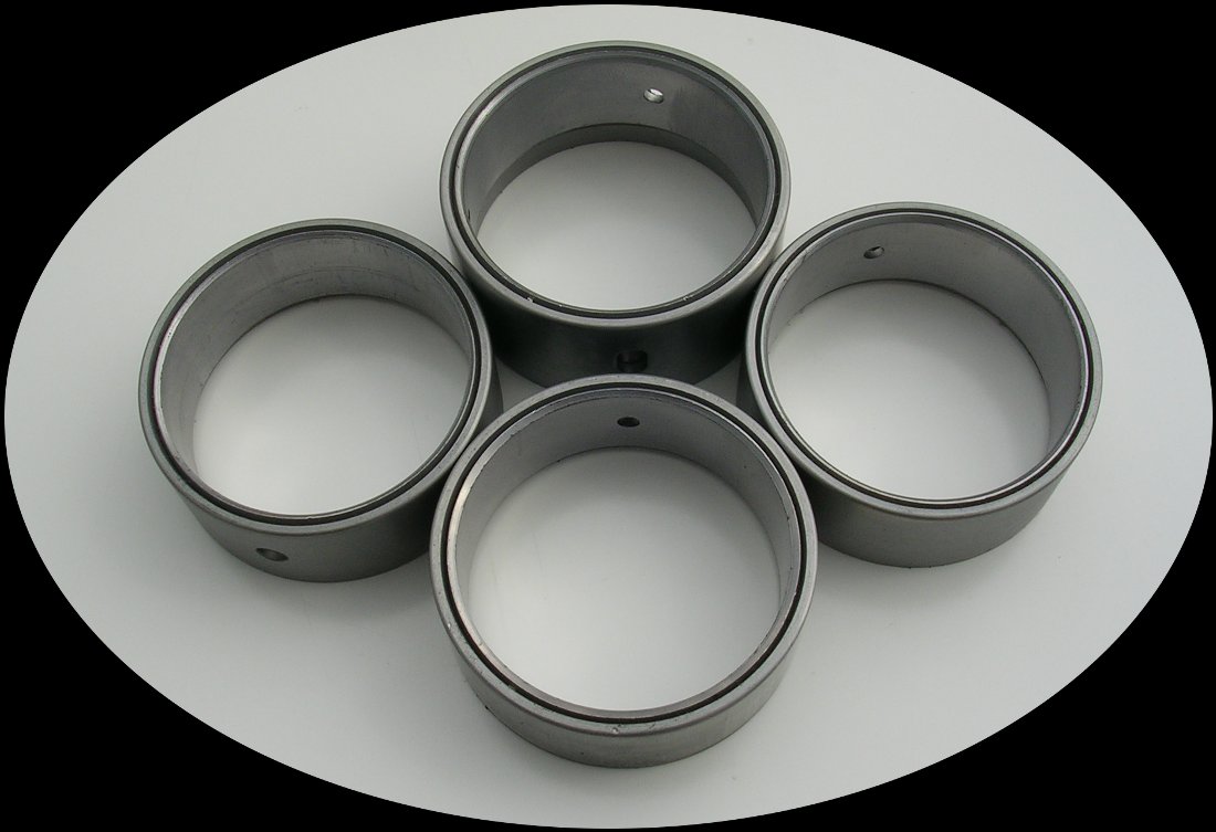

        There are a few LZs being built using the cam bearing spacers. We ran a small batch of spacers several months back. With the spacers, you can use a GEN-III cam and TC setup.

          Does the gen3 timing cover fit the gen4 and match up with all the coolant ports?
          So all is needed is the cam bearing spacers and you can throw in a gen3 cam? I don't see them listed on your site. What holds the spacers from moving?

            There is an outer shell that a stock GEN-III bearing fits in. Then the assembly presses in like a standard bearing. In the end they are like thick walled bearings. I haven't added them to the store yet.
            The older covers will bolt to the block.... BUT... you still have the issue of the coolant return system since the LZs have U-flow cooling. I have a couple of ideas but haven't done anything with them yet. As I always say... time and money.

                  Can you use the gen3 setup, with the gen4 cover, and then make a flat block off plate for where the phaser went, that would give more clearance? Will the gen3 chain/etc fit under the gen4 cover?
                  If you add those cam adapters to the store I bet they would sell... lots of FWD people could then start using the engine with the external trigger and 3500 UIM...
                        I think it sounds pretty good, more like a high end european motor. Some of the sound difference is due to the length and diameter of the exhaust. An easy way to address the U-coolant flow in the 3900 for fwd cars is to turn the heads around so the coolant passages exit to the rear and connect them with a "Y" tube welded to flange plates bolted to the heads over the outlets. You'll have to add a water fill neck in there somewhere, perhaps an inline filler neck instead of welding onto the "Y". Hope you plan on having it dynoed soon.
