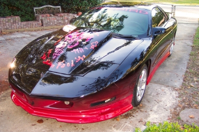

                not computer related. I just had to say that bird is gorgeous!
