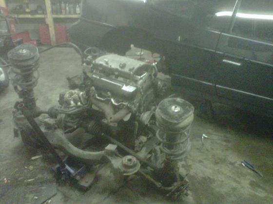

    7730 ECM swap, easy enough, good writeups online...
    Added a 3.5mm audio plug to the stock deck... if anyone wants to do this mod just google "ipod Delco radio" and shit will come up, it's easy enough to do...
    Old wrecked Cavalier engine is IN (no blower) :
