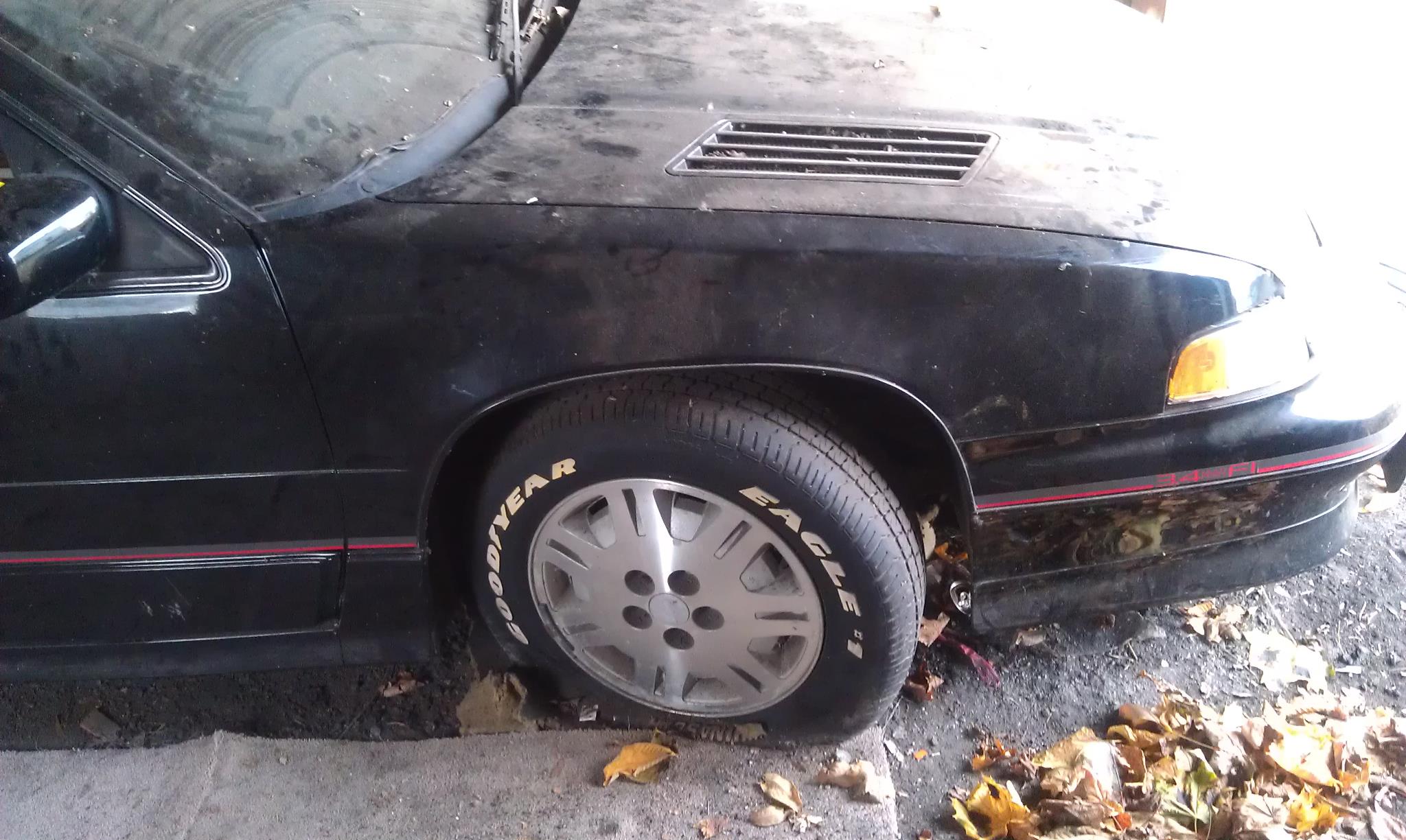

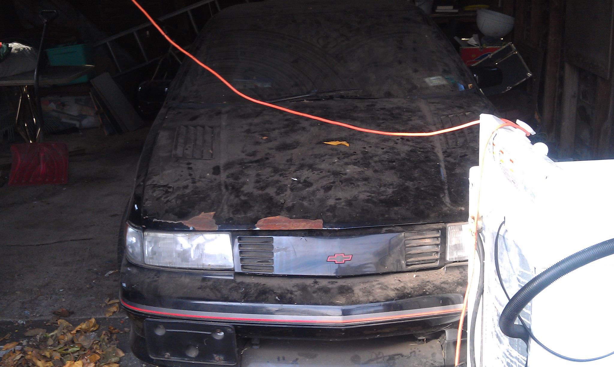

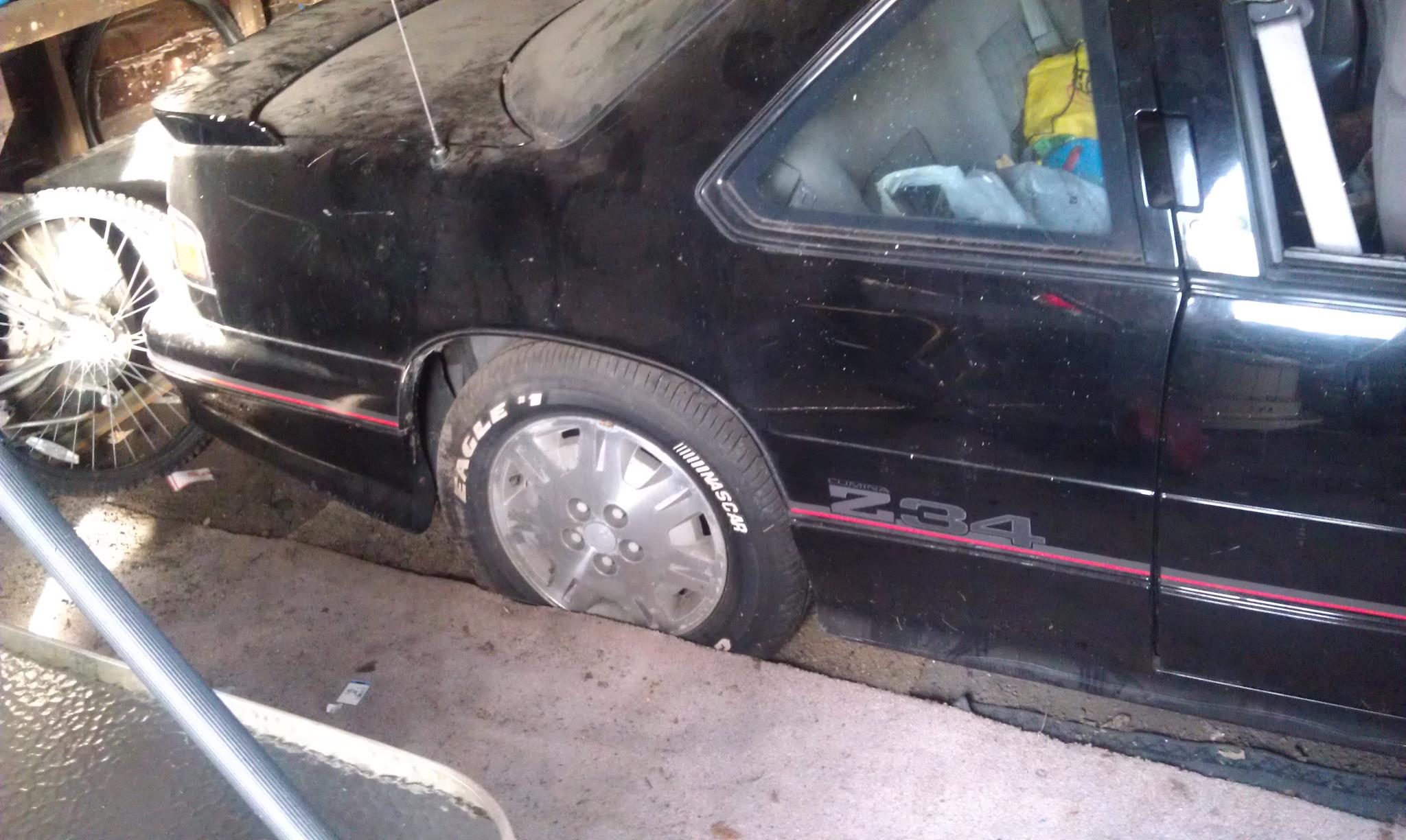

    Hello first off I'd like to introduce myself, Im 17 I live in Upstate New York and I'm now the lucky owner of this wonderfull barn find.

    Welcome. Check for major rust issues first under the car if that clears..then proceed. For that age and millage, you'll need to drop the fuel tank and replace the fuel pump and drain out that old bad gas. Get a fuel filter. Do a oil change and see how it runs and if the transmission gears work.

      Welcome! Clean that baby up!
