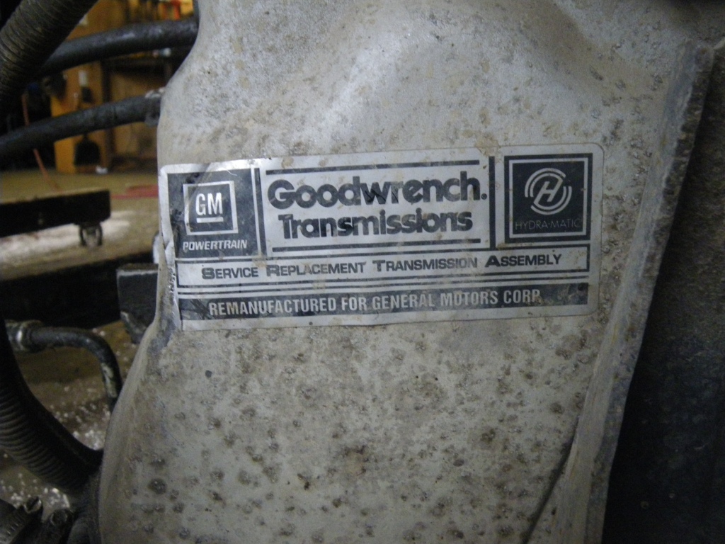

    Well the tranny made it 4000kms on the white Monte, 4 round trips to work. The second trip drive really started to fail, it would hold up to 3500 rpm then slip and would just slip into a like neutral state instead of down shifting. After that trip I pulled the guts out of the green parts car. Found a promising sticker.

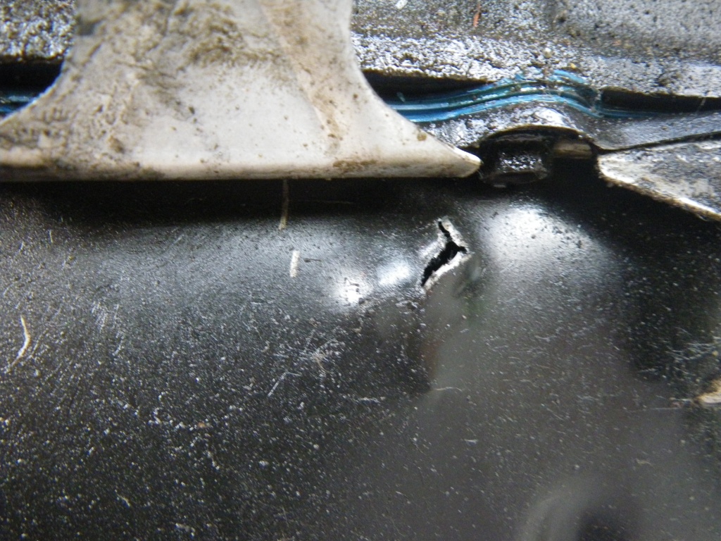

    I then pulled my car apart last shift out and swapped the trannies. Also I had a good look at the motor out of the green car when I separated them. Eeeh
Name:	Oil pan_s.JPG
    The pan was dented in four spots with tearing at two of them. On both sides of the pan at 1-2 and 5-6. The block doesn't look cracked. Wont know until I pull the pan later. I knew that that was a horrible noise when I was testing the tranny.

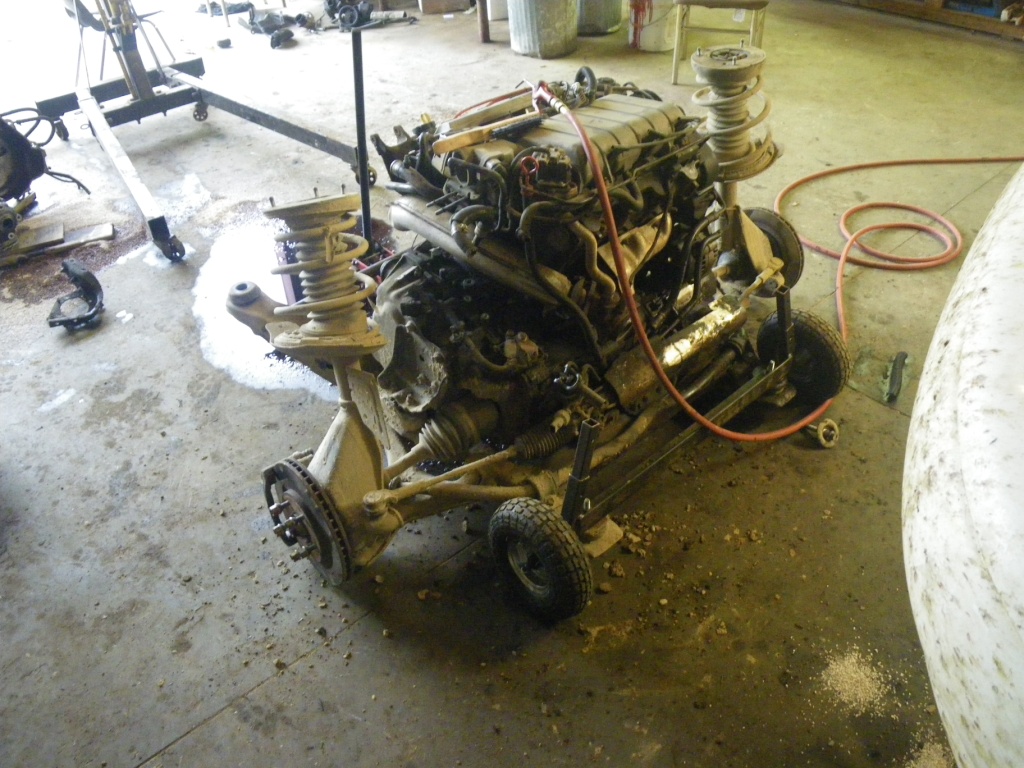

    Here is a cradle for the back of the sub frame that I made to make the swap go a little faster. Just lower the frame and bolt it on then use it's wheels with a floor jack and roll the powertrain out from under the car.

    The newish tranny is nice. It works perfectly. Just need A/C and the car is golden.

      So most of the weight is on the jack with that cradle? I'm shocked that those little tires can take that kind of weight.

      Grand Prix trans with 3.33FDR
          Snapped rods on that engine?
          About 60-65% is on the rear wheels, LOL. There is 60 psi in them (what there rated for). They are actually fairly strong for cheap wheels, "Yard Works". I put a piece of 1" sch 40 pipe between the tow rope slots for the jack the first time I used it and it had a mean bow in it supporting the weight. Now I put the jack under the front section of the cradle directly. Works pretty good considering I built it in 2 hrs. I used the tractor to lift the green car off of the motor and damaged the rad support, figured this would be a good solution to keep my good car from getting damaged.
