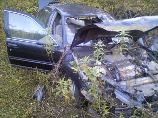

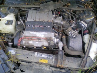

    Hello new here. I live in warren Pennsylvania, I have a 98 chevy lumina i bought for 400 dollars in Nashville tn with a locked up engine. i love this car i recently bought a totaled 95 lumi with a 3.4 dohc. it only has 106000 miles. Im going to regasket the engine new timing belt while it is apart do the 13 degree timing mod. also thinking a shift kit kit and a 3000 rpm stall converter. any thoughts?Click image for larger version

    With the auto you may want to go with the 6&6 timing. The 13* is better suited for manual cars and you won't be able to use some of the better powerband up top due to the shift points in the auto. The lopey idle of the 13* may also make the car feel funny while stopped in gear. The 6&6 idle is smoother than stock and you gain low end torque, something the DOHC isn't known for.
