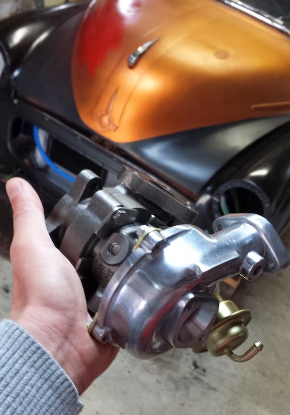

                    Cool project, and welcome!
                    What's the plans to get 300hp out of the iron head v6?
                    Just kidding, that is going on my Mini. Well I'm gonna see how it does with it's current setup of stock, minus a lot of deleted stuff. But I have thought about a small cam and port/polish the heads. We have talked about a small shot of juice, I am fabricating from scratch a turbo setup for my 76. If that turns out okay, I may look into that, not sure how the tuning would play out on the obd 1.5, but there are always options. I have a feeling though it will be a good power to weight ratio as is. But should be easy to add on later when we get bored of it.

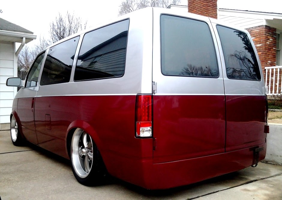

                      Is the ride bumpy on air? In all the years I have never been in a car that had it.
                      Grand Prix trans with 3.33FDR
                      • notabmw1
                        • Nov 2013
                        • 13
                        It can be bouncy without shocks, really depends where you set ride height at, bag size, etc. My van used to run 150psi up front to get to ride height with 2" drop spindles and RE-6 bags, I then swapped them for a RE-7 bag and that dropped pressure almost down to 100psi, so it gave it a softer ride at ride height. Rear is never a problem because you have more room to do almost whatever you like.
