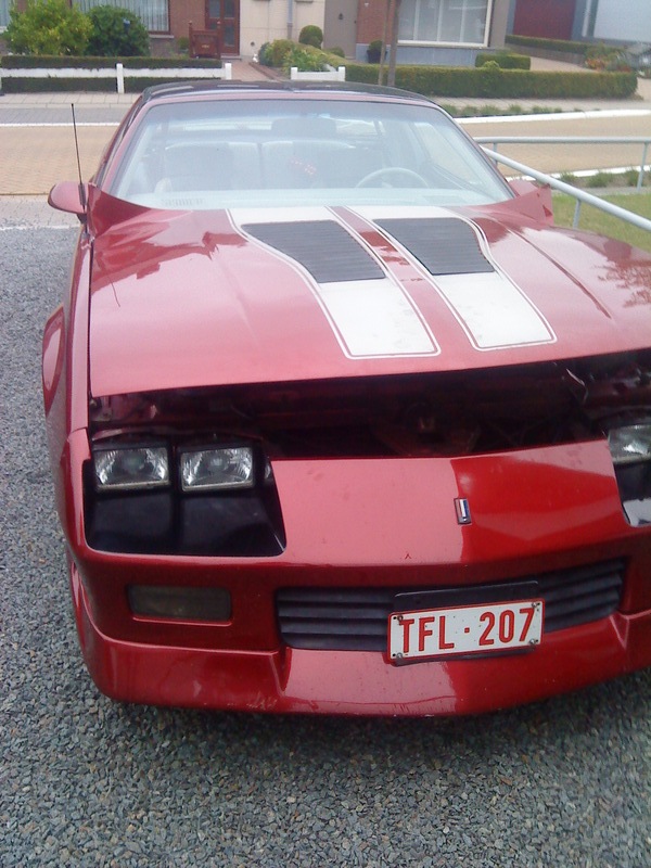

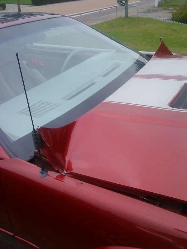

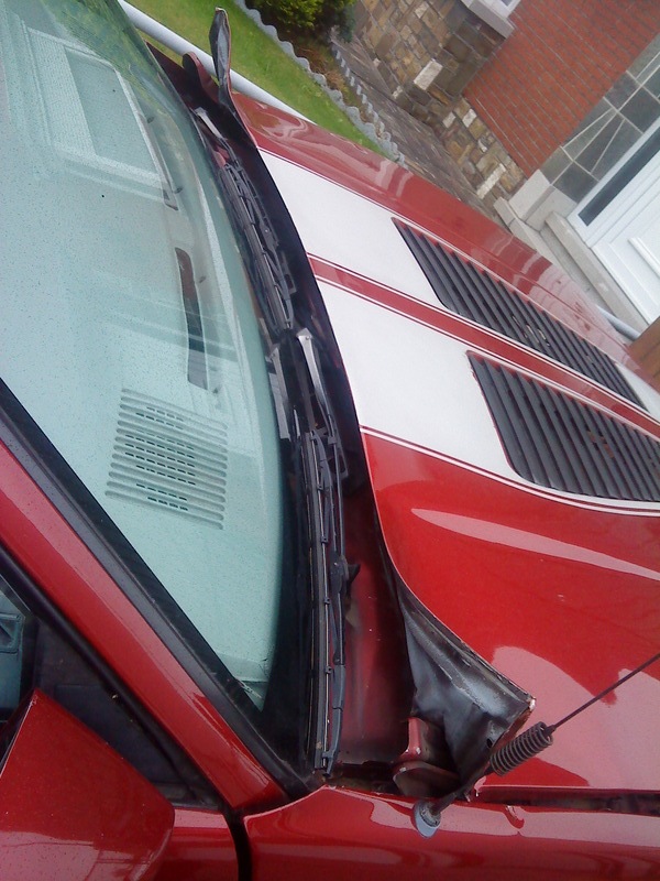

    In 2011 I had an accident on the highway where my hood flew open.
    these is the result

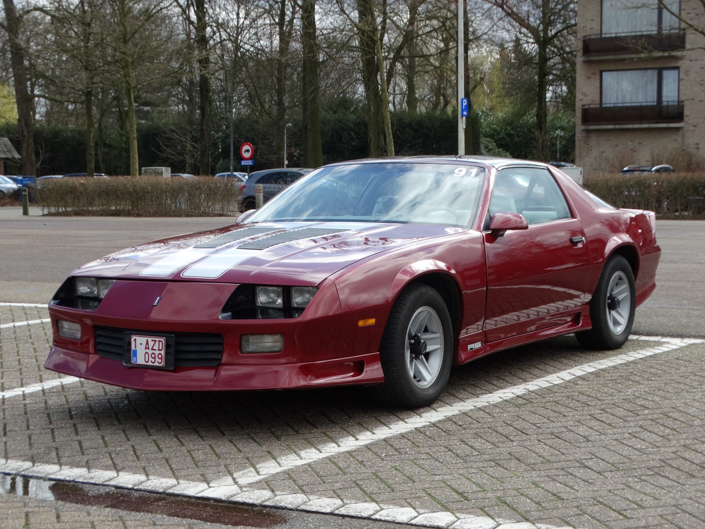

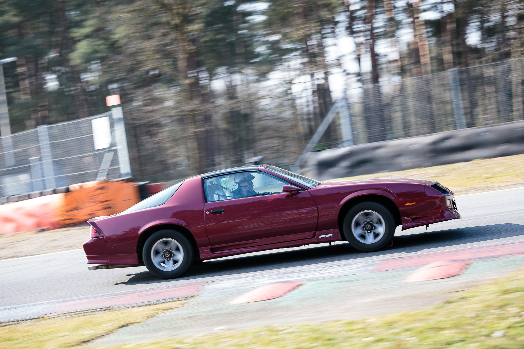

    now since we I decided to restore it.
    so I ordered a new hood and fenders.
    repainted the WHOLE car in the original color with silver ( thirdgen silver ) striping ( painted )
    modding isnt really allowed in m country, BUT I did some mods
    suspensionwise
    black polyurethane rubbers
    34mm front 23mm rear swaybars.
    BMR wonderbar
    Koni 3th gen front struts with new strutmounts.
    koni 4th gen rear shocks
    Brakes
    powerstop front rotors with Z36 brakepads
    , new bearings,
    new calipers
    new rubber lining
    stainles steel brake and fuel lines front to back
    rebuild transmission with atp shift kit and extra oil cooler.
    engine
    is a 95 camaro 3.4 V6 bored 0.5mm over
    completely dissasmbled rebalanced, shaved heads 0.5mm
    new valves, new seals
    comp cams 264H cam.
    Pacesetter headers
    Heated O2 sensor
    , empty cat
    dynomax VT exhaust ( I hated the poopmaster droning )
    hawksthirdgen ramair intakeboxes
    Intake and sensors are reused from the 3.1 V6. so on the outside the car looks stock.
    trying te do my own chipping
    LT1 dual fan setup, ( 1fan ecm controlled, 1 fan with thermoswitch between radiator fins )

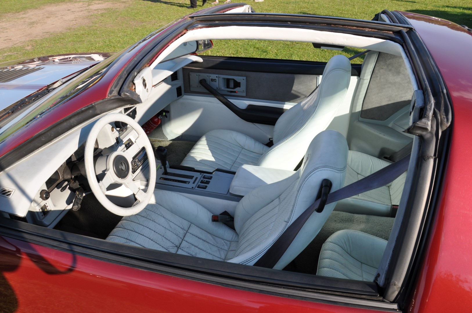

    Other mods include a custom interior
    -97 camaro white vinyl seats and white interior doors and roof.
    interior fully done with raamauto.
    Nordskog gauges
    New wheaterstripping all around
Name:	127 (Large).jpg
