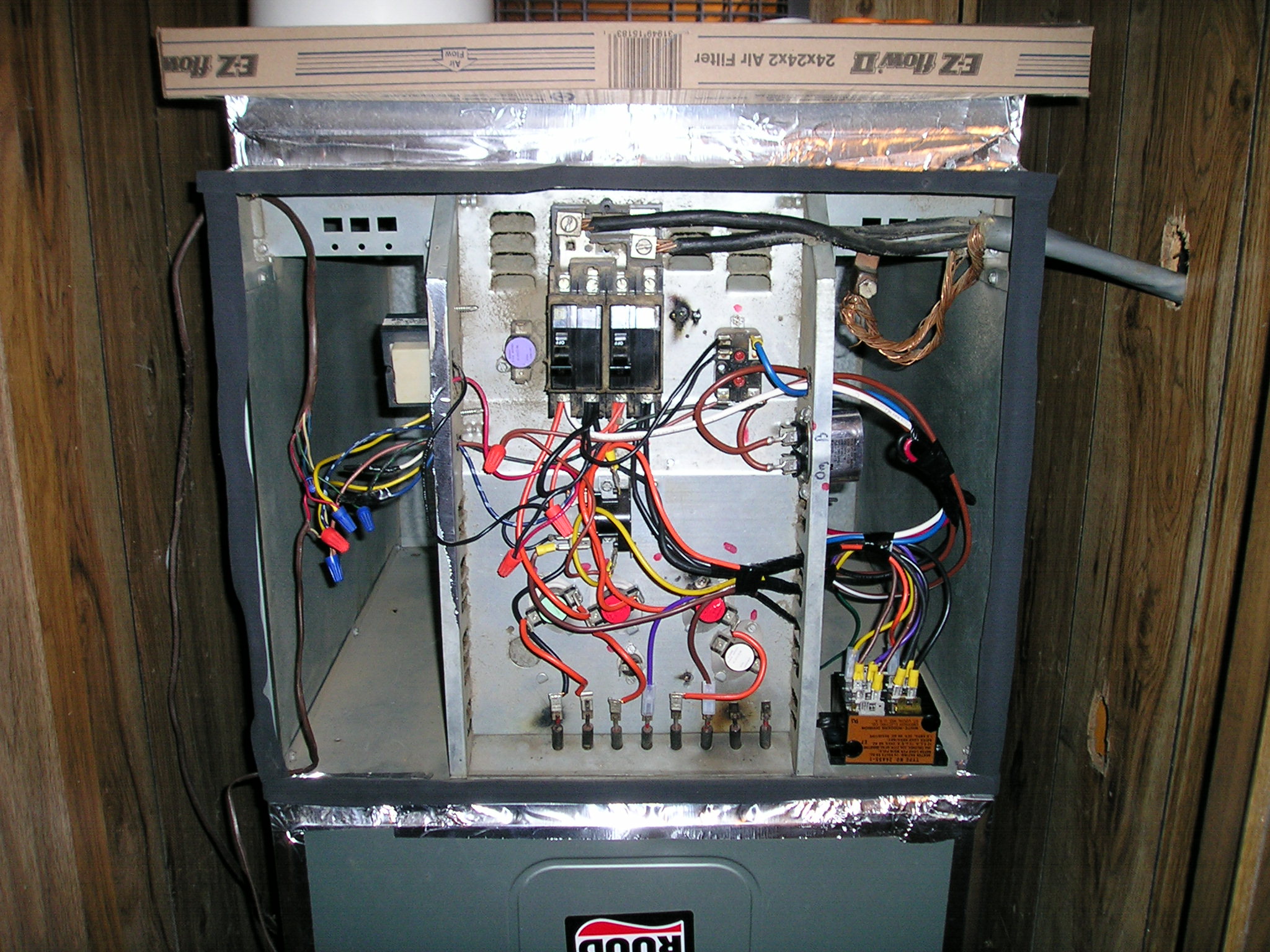

                    The pictures:
                    One is my crappy Rudd heater that I had to retro fit several times, it is down to 3 heat coils, relocated and used a heavy duty seqencer that is used in spas, replaced the motor and lifted the filter away from the intake. Rudd does make part for this anymore and this model was discontinued and recalled in 1997 and the previous owner didn't feel like replacing of course I found this out after I closed. It is setup as a open central return down flow, sometime in the future I am redoing everything and adding a regular return plenum and duck work.

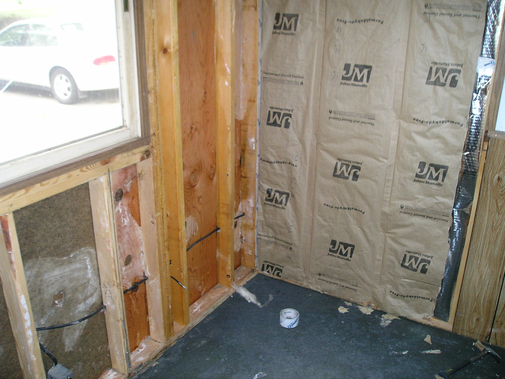

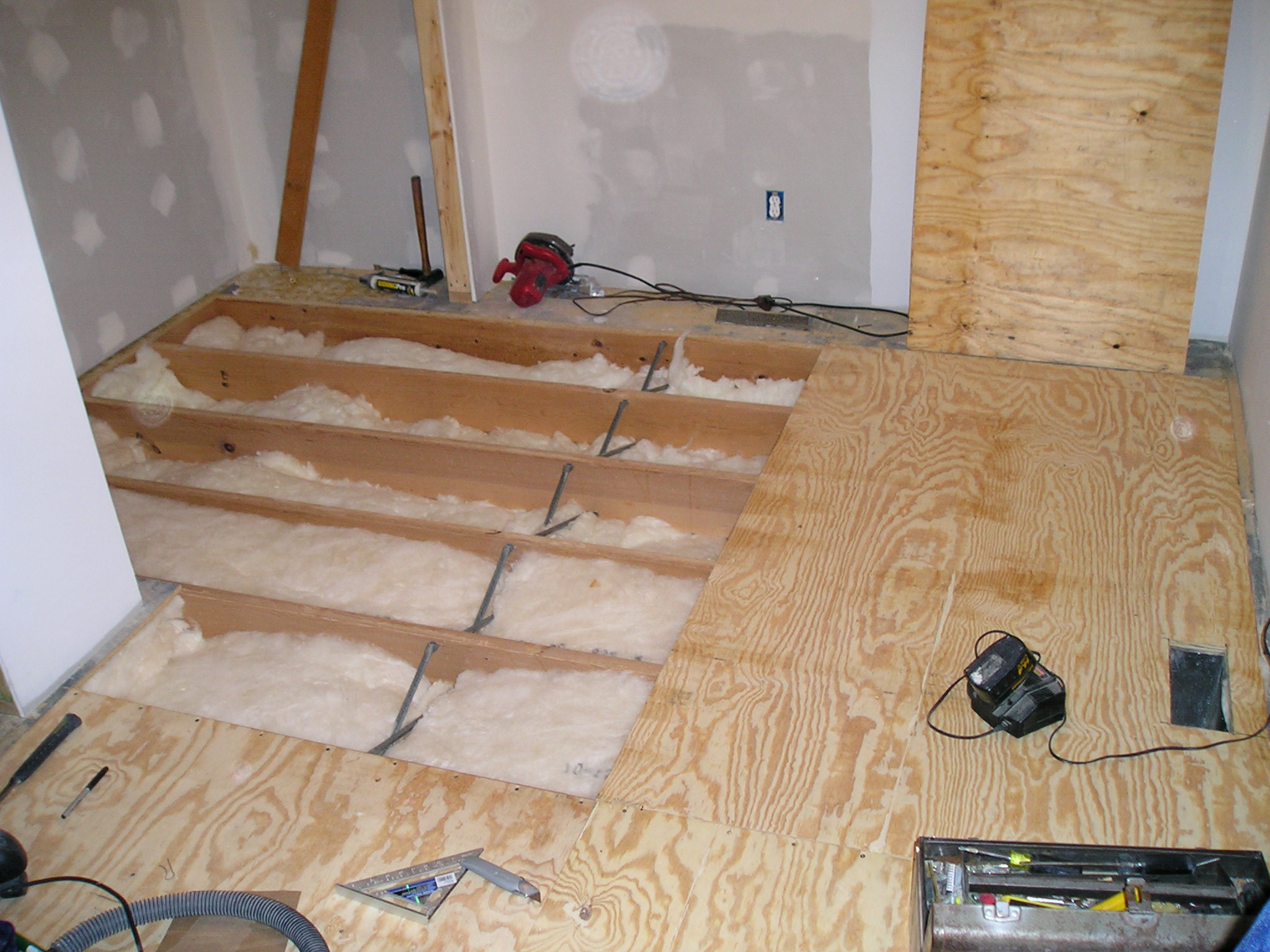

                    The renovation pictures show most of the work done I have tons more to document:

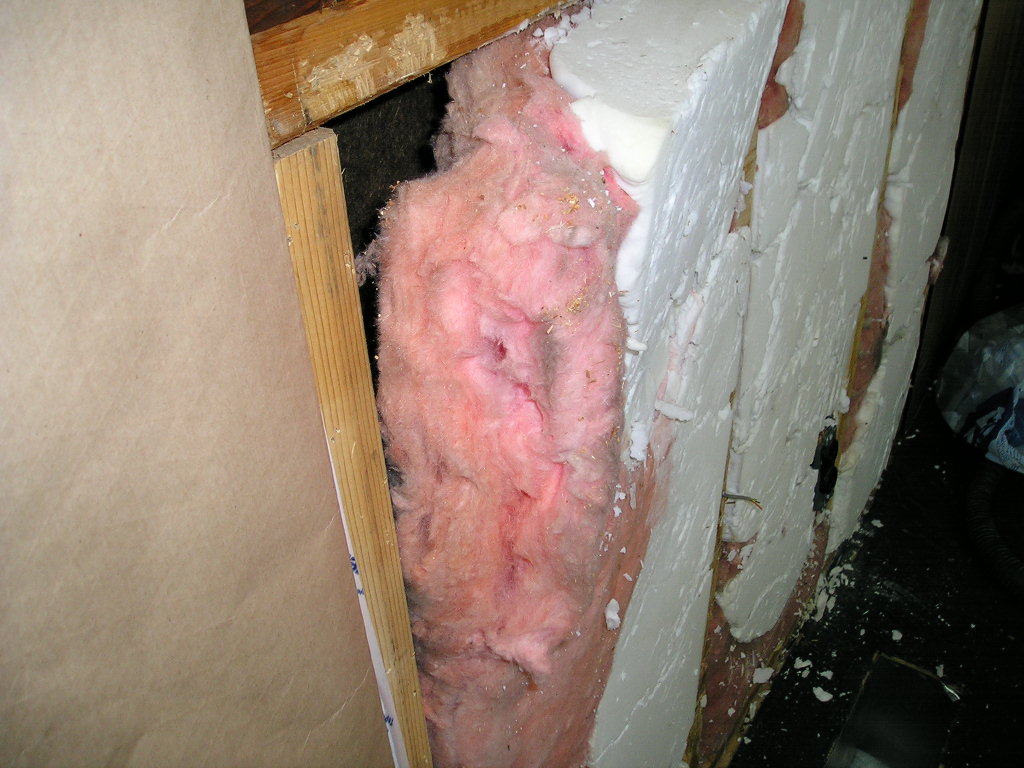

                    The picture of the pink insulation is what was in the walls, junk.
                    I did 99 percent of all work floor to ceiling. Used Radiant barrier in the walls with R15 insulation, rerouted electrical with new boxes and outlets, new 1/2 sheetrock on the walls and 5/8ths gypsum on the ceiling, most of the floor was replaced with 3/4 sturd-I-floor, reworked door and closet partition with new studs.
