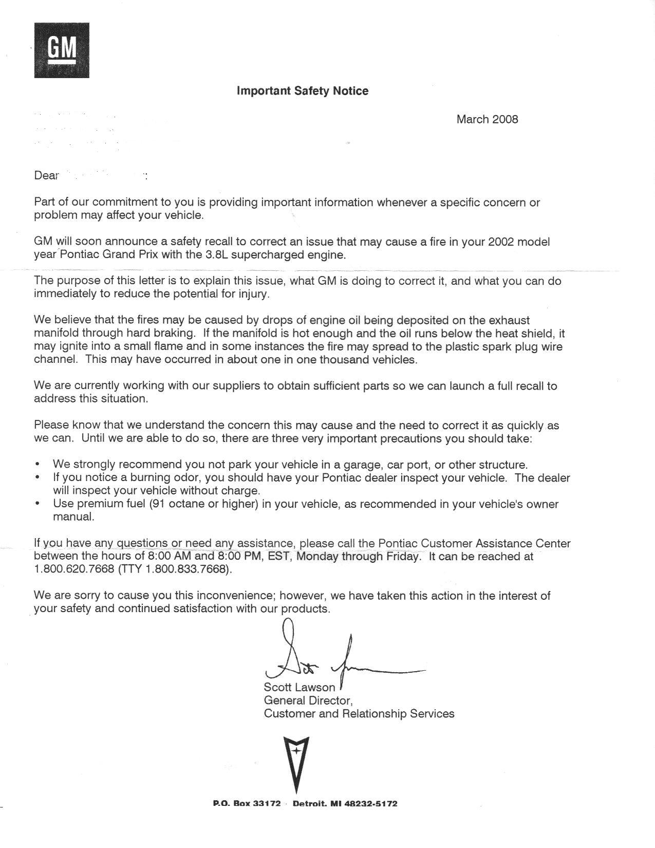

    My parents got this notification in the mail. Can't you just feel the urgency of their warnings?! It's kinda like the owner's manual warning...do not run the engine for extended periods of time past the red line or engine damage may occur.
    For me, I can click on the picture two separate times and get a much bigger, easier to read view FYI.

      What on earth does 91 octane fuel have to do with any of that?
        Excessive heat from KR due to using 87 Octane.

            Solution: WASH ENGINE.

              i just love the if you smell something burning have a dealership look at it. no, don't get out of the car and make sure it's not on fire! haha!

                OK, simple solution, QUIT USING YER RIDE AS AN AUTOCROSSER in traffic!!

                  Stupid plastic valve covers!!!
