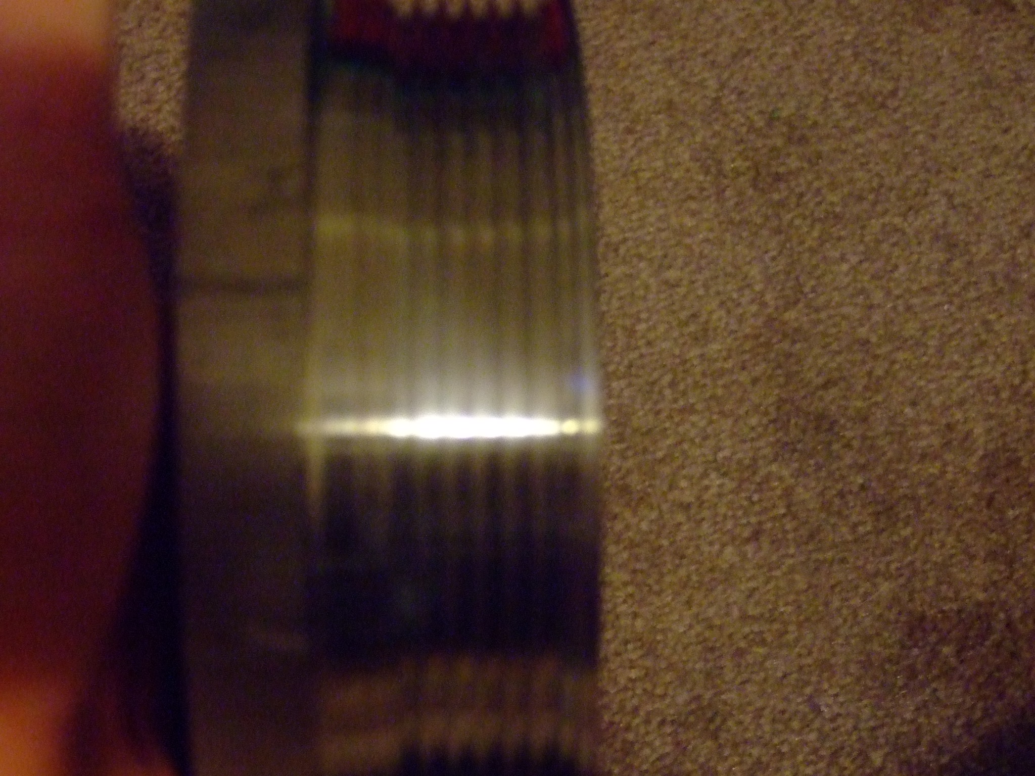

    K, we gots a Mori Sieki NL2000. No Y axis, so I'm programming on the C axis. But to give you an idea, I'll post some pics below of what I done. I took a piece of 6" aluminum round stock and started cutting for a pulley. Trial and error took awhile since I couldnt get the right G code to use an R value on the same line with C and X to cut a straight line. Anyone want to share what they might know. Can make parts cheap, I dont have any cad software, so its got to be simple enough to use a calculator on. I just did the face side only, got this done earlier today..

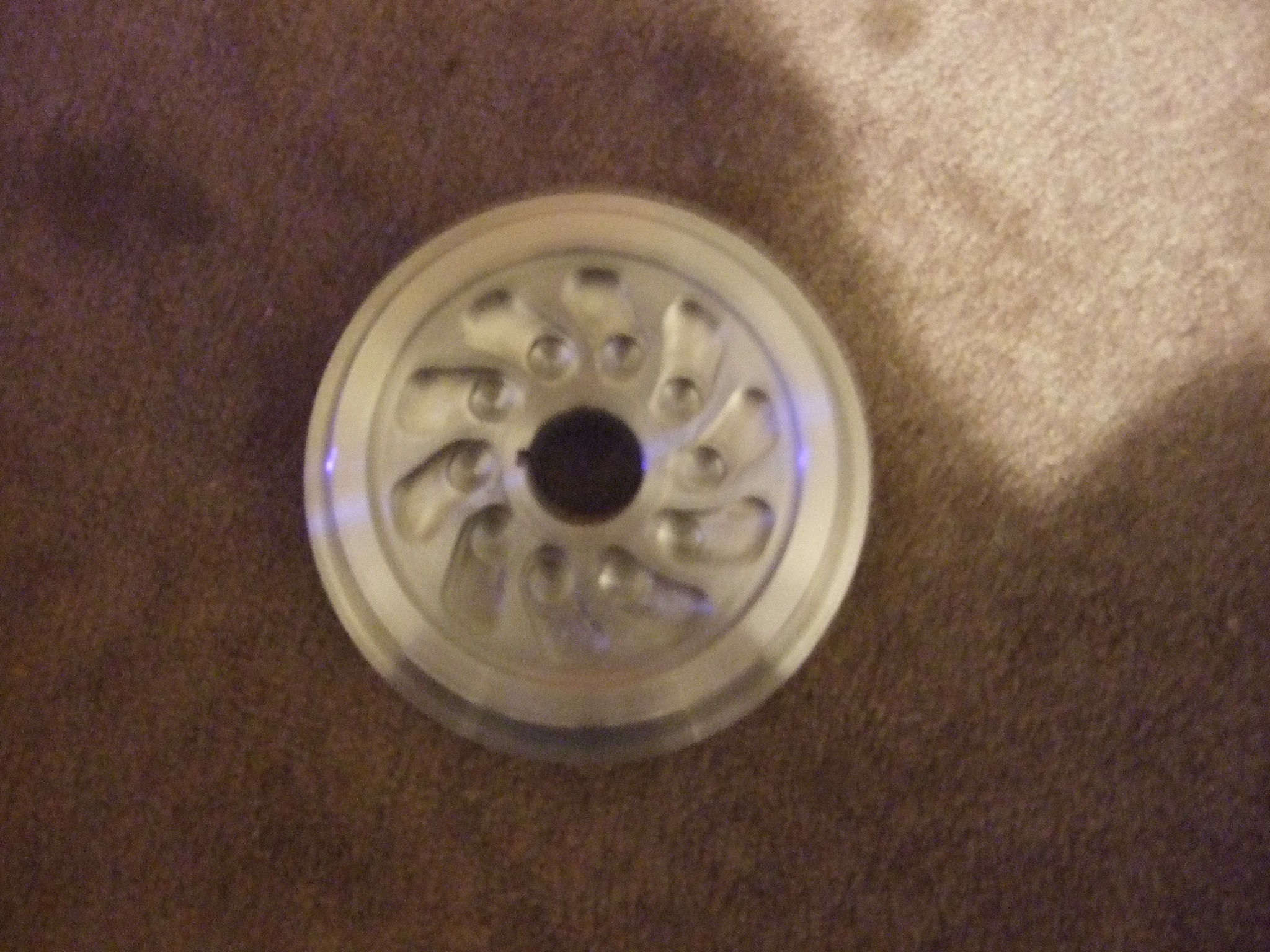

      Well I tried to do a 5 spoke design pulley on a live tooling lathe, Mori Seiki NL 2000. We dont have any cad yet, and our Mori has a Mitsubishi Controller. On our Lathe, X is up or down, Z is in or out, and C is spindle direction in degree. So after I used a 1/2 drill in the face at 72* intervals around the part, I took a 1/2 E-mill to mill out the pockets. I feed in where the holes were, and feed up in X and rotated C to a plus 15*, next move went to minus 15*, next move went back to start point of X and C. That didnt produce what I was looking for, so I then edited program, and again, and again, I'm only skimming face about .005 till it looks good. I desided to settle on a 10 window design thats in the pics. This time I went for a tear drop look. I went up to X point rotating C to plus 12*, then rotated to a plus 20*. back down past X start point with a C of plus 2*, then X up with C at 12*, back to 20* then down to C 0 and X start point. Looked good.
