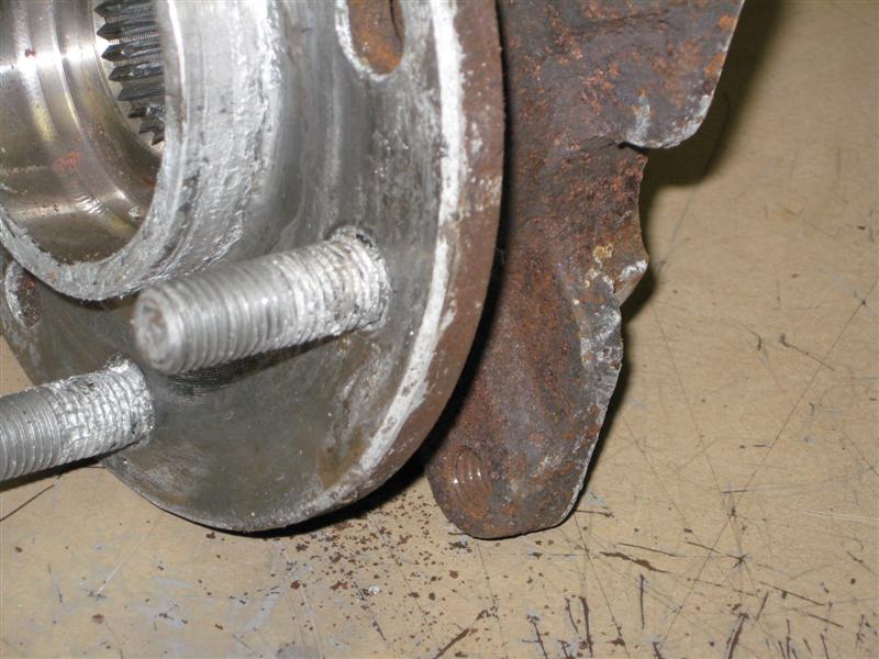

      These are the best pics I've got at the moment.. Should get the idea.. The axle has to be an inch or more in dia and is splined to match the bearing. The big nut on the end of the shaft pulls everything tight... And you DO need to "Ape" it on there. I think the torque is around 250??? We are saying "Bearings",, Hub Assembly is the proper term I believe... If better pics are needed I can take some better ones tomorrow.. Camera is in the car and the PC with USB isn't started up.. Just got in from work and I'm lazy!!
      One thing I've noticed with aftermarket "Hubs" is my 99, plain Jane Lumina, doesn't even have ABS, has the SAME part number as my 93 Z34. Don't know if GM numbers are the same or not.. The point of this is the Z34 rims sit out about 2-3 inches further than the 99 Steel rims on the 99... I have swapped them. That would add more torsional (?) force... Perhaps that's why we go thru these things so quick.. Maybe later I'll see if GM lists different numbers between models....
      Hope this give you an idea of what a W-Body bearing/hub looks like....

            Excellent breakdown on everything... Thanks! I can see that the "bearings" that are part of this wheel hub assembly really are "sealed"...although the one you removed and took images of looked like it had some rust on the outer race areas. Do these breakdown and have the bearing segments rust out underneath or inside of the bearing seals and make all that "growling" racket and noise?? If they do...then it has to be happening because of all the rotational stress of front engine torque ...mixed in with the front wheels being turned back and forth for steerage that must be the killer. Now I have a better understanding of the problem... No hand packing of the bearings required.
