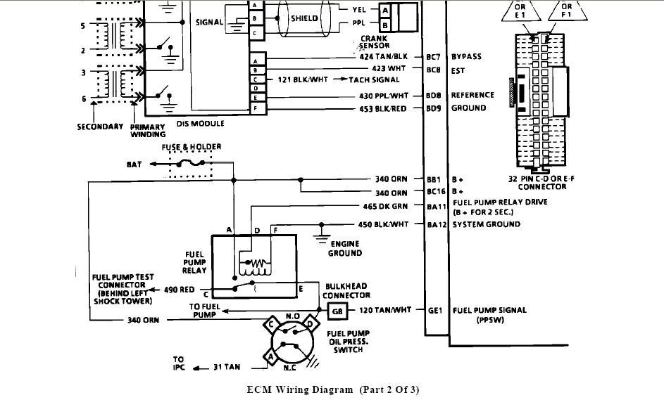

    we are putting a 92 3.1 in a sandrail frame we are needing the ecm pin outs and wiring diagram for the oil pressure switch and alt.

        sorry it was a 92 cavalier 3.1 mpfi with a 7730 ecm we are wiring it up basicly stand alone. I have everything wired but the oil pressure which was a gauge we are wanting to put a mech gauge can I wire that input high(+12dcv) maybe the book I have has a misprint but they are getting 12v form the oil pressure and /or the fuel pump relay and the other thing is the alt. not sure how I am going to excit it yet also there is a sensor in the head I dont know what it is 2wires blue and green I believe.. thanks

          The oil pressure switch acts as an backup power feed for the fuel pump when there is oil pressure. The system will work without it or you can use a "T" to keep it and use a mechanical gauge.
          IIRC the wire to excite the ALT is brown or brown with white.
          I am not that familiar with the GEN-IIs but would guess that the sensor in the head is for the temp gauge.
