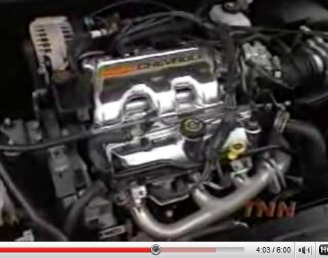

                          Those headers were kind of funny looking. Long-tube maybe? Large-port topend as most (if not all) 3100's in 98 were still using the small-port parts.

                            Those really weren't headers from what the front manifold looked like. Looks like the 3800 style manifolds. Headers would have all the primaries going into a collector so you would get the scavenging affects. Those were just tubular manifolds.

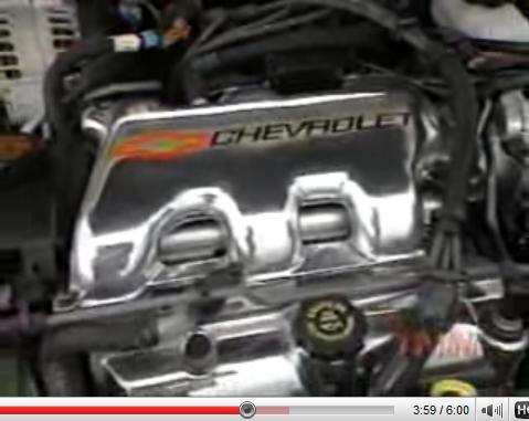

                            The malibu had a 3400 in it, if you read the comments on the videos it says upon further research it was a 3400... And yeah you can tell it was at least a large port manifold.
                              "Did some googling. My bad, its a 3400.
                              From Popular Mechanics: ...A 238-hp, 3400 pushrod V6 borrowed from the Chevy Venture minivan. It's been enhanced with high-compression pistons, a high-lift camshaft, stiffer valve springs and better breathing.""

                              EDIT: some quick pics...
                              1. shot of the intake: definitely a large port, and with no script on top, PROBABLY came from a van.
                              2. full motor including the exhaust manifold: what a funky design...
