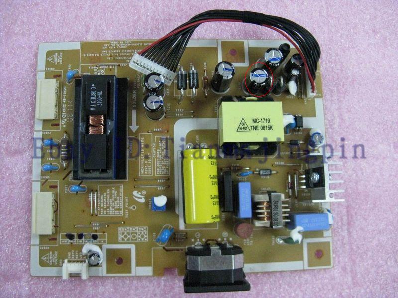

                      That PS looks easy to work on, and not many components.. I'd try replacing the caps and any diodes next to the transformer and slap it back in first. Radio shack should have the components still (unless they are totally cellphone shack now) or any other local electronics store.

                          From that ebay pic, looks like they replaced the electrolytics. I'd replace them and the 2 diodes by the stepdown transformer. The inverter trans is probably ok if you have no power to the whole LCD then it's probably just the power board. Now if the power LED came on and you could see the screen with a flashlight then it would be the inverter or bulb of course. I'd test the 2 large diodes too and any others though.

                            • 9186
                            IIRC, the circled cap is the one that is bulging. If I am understanding the layout of the board, it looks like that is on the inverter side, not the PS side. I'll pull it apart again tonight and see...
