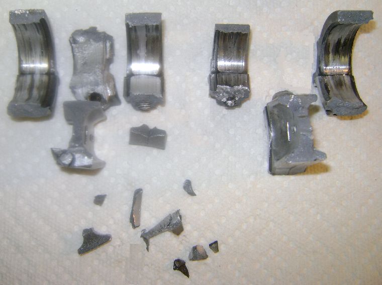

    By now...you've met most of my immediate neighbors in one way or another via some of my recent Off Topic Posts and those all concerned unique vehicles of one kind or another... But this one involves the neighbor to my left who is one sad soul in so many ways. Here is a man who keeps getting kicked in the teeth by Life and who is ill-equipped because of his having "Chemo-Brain" while dealing with a recent bout of Non-Hodgkins Lymphoma.
    In short... Bob "S" can't do anything without getting in trouble...and in this example you'll all understand why this keeps happening. Now since I treat all of my neighbors with decent respect...I can't isolate Bob from the help I so willingly give to the others...and perhaps because he often even needs it even more so than they.
    The latest tragedy to befall this man is that he was talked into buying a 24HP Craftsman 42" Wide Dual-Blade Riding Lawnmower...to cut the grass areas around his Brookesville home... an area that approximates the size of a f*cking postage stamp! In any case... Bob called me up to complain that his Riding LM was not working right...actually...not working at all. He explained that he and some other local redneck neighbor in Brookesville, Florida (his Mom's Home) decided to take a 6" section of galvanized pipe with an elbow and a plug...and screw this apparatus into the drain hole in the lower right side of his $1,422.29 V-Twin Briggs and Stratton Intek Engine (B&S Factory Replacement Engine value). Now this all might have turned out okay...had Bob only wrapped some Teflon Plumbing tape...or put some thread sealer on the plug...and no one would be unhappy today... But that didn't happen. It probably took the better part of a week or two for most of the oil to drip drain from that damned loose fitting plug... but it certainly all left the crankcase in its own good time. And soon after...Bob decided that before the Fall gets here and he loses the opportunity to cut his little patch of grass...just one more time... He jumped in the saddle of his Rider...cranked up the engine to about 4,000 RPM...and did this to it:
    Anyhoo... I listened patiently to my friend...and told him to trailer the whole rig down to his 'soon-2-b-ex-wife's' house next door to me...( Yes...even she is abandoning this poor slob) and said that I would help him look into the problem. As you can see from the images...with all the major components so badly damaged...including the Main Case having a cracked #2 Cylinder at the bottom and the webbing in the block that houses the Camshaft support/oiling journal in the webbing all cracked and swollen...This motor is a complete bust for repair. But even a tale as sad as this one can have a Silver Lining. Last night... I "lurked" over on eBay and stumbled over a Briggs and Stratton 27HP Intek match to his motor and managed to snag the motor for $360.00 with Free S&H for the guy. At the very least... come Spring ...Bob will be cutting his little grass patch; Riding High on his Craftsman Riding Lawn Mower again...
    that's one FUBAR'd motor... the way that cam twisted is sick.

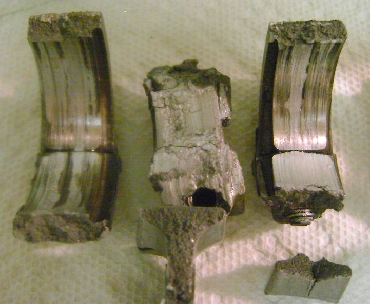

        What troubled me the most after I hit the center of the bottom of the crankshaft with a Dead-Blow Hammer to separate the casings and saw that pile of shattered aluminum "I" Beams from both of the ConRods was remembering how incredibly heavy the flywheel on this engine is...and thinking, "How in God's Name ...can Briggs build an engine like this... knowing that a HUGE amount of torque will be developed... using connecting rods entirely made of nothing more than soft Cast Aluminum?!" I have yet to make a closer examination of all that Metal Mung I fished out of the lower cases to determine if they even used any kind of Babbitt bearings in between the rods and the dual-wide crankshaft journal. The more I think about it...all the stuff giving the crank that silvery mottled appearance is probably just melted Aluminum!

            A Return to The Scene of the Crime...
            For a quick view of the Connecting Rod reconstruction images...Please use this link...
            Originally posted by pmaniac69 View Post
            ...everything on a Briggs motor is aluminum except the crank, and the flywheel really, but they are just like any other motor out there, they don't like running without oil!
            Everybody disses Briggs and I will never understand why. I love their design over Honda and Tecumseh any day of the week. They are easy to work on, and never have as many problems as Tecumsehs do (even though they are out of business now). I've been working on small engines for over 5 years for a living, and I'll take a Briggs over a Honda any day of the week
            I believe that your understanding of how this engine came apart is profound. The images posted here are proof that oil starvation was the cause and origin of the cascade of excessive friction between the conrod bearing surfaces and the main crankshaft journal. Metal fatigue of the weak aluminum soon followed...and when the contacting parts could not take the stress any longer...the conrods broke into pieces that went into other gearing areas where the camshaft meshed with the crankshaft gear. When this happened, the camshaft bent dramatically and while rotating... the lobes made contact with one of the cylinders and broke out a piece of the lower cast iron sleeve. The warped and bent camshaft continued to rotate enough to shatter the upper case oiled journal like a twist drill and broke that area apart enough to dislodge the gear teeth from the ones on the crankshaft. But by then... the damage was done... and so was this motor.
            I'm happy to defer to your knowledge and empirical experience with the Briggs and Stratton line of engines. So, you'll get no 'dissing' from me in the general sense about the design of this V-Twin motor. It really is quite a remarkable design. But to do so much in the way of making this engine work and then fail to use either a cast, powder metal or forged steel connecting rods in lieu of aluminum ones having NO BEARINGS, is to me is just a sin. Either the folks at Briggs are hugely short-sighted...or just plain sinister for the sake of "planned obsolescence" to guarantee that expensive repairs on these engines are just inevitable. Had the rods been made of "Stronger Stuff", so much additional and destructive damage could have been avoided.
            Imagine what a Superman of a Motor this engine could have been if they would have included two, self-lubricating bronze bearings to support the crankshaft instead of using only one in the lower Sump case... and with steel conrods, they could have easily doubled their HP output with some tweaking of the timing and compression. My God...this thing not only has a genuine gear within gear driven oil pump... but also sports a centrifugal oil slinger like the ones used on radial aircraft engines! To do so many clever things and go cheap on the one metal item that must change direction hundreds of times a second and get pounded with hundreds of thousands of pounds of force... is just plain STUPID!
            My reconstruction images (the best I could manage with what was left) can be seen here:

                  the problem with the v twin engines is that they NEED to be full of oil at all times, they aren't like they old slinger or dipper oil systems which, even if its somewhat low, there is still oil getting thrown somewhere
                  the v twins have an oil pump, and if the oil isn't where its supposed to be, this is what happens. I had the same thing you did on a 14 horse v twin horizontal shaft, it was approximately a quart low on oil, and the customer was complaining about it making a NASTY sound. I took the cover off and the connecting rod for the right had side (being behind the motor) had shattered, and destroyed the main journal on the crank, but somehow, miraculously, still ran on one cylinder lol

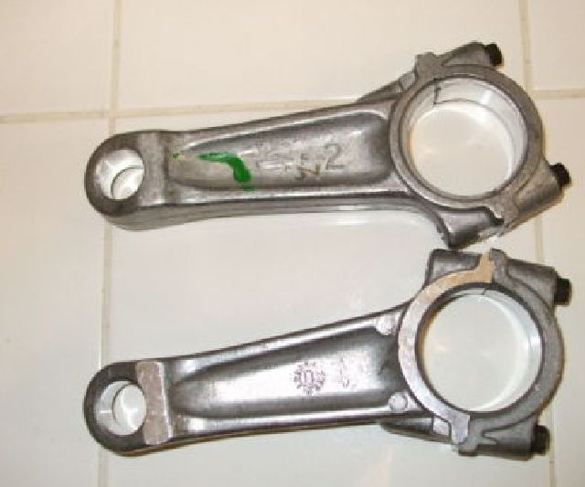

                    Last night... I had this very conversation with the man about not going anywhere NEAR that machine without holding a paper towel in one hand and the engine Dip Stick from this "Rescue Engine" in the other. So your advice is timely and will be covered as many times as it takes me to drive the point home. Thanks for the excellent advice!
                    I was wondering whether the Kart Racers have a line on anybody who makes alternative connecting rods out of something other than "Graham Crackers" for these engines...
                      i know for some of the smaller briggs motors, they make a billet rod to replace the cast ones... or was it "cast", i forget...

                          Here is the used Camshaft Kit:
                          http://cgi.ebay.com/ws/eBayISAPI.dll...=STRK:MEWAX:IT
                          Here is the Crankshaft Kit:
