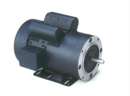

    ok so ive looked all over and even used the numbers on the starter itself but come up with with either dead links or dead ends.
    so i turn to you guys which might deal with these kind of things more than me.
    ive tried going to campbell's site directly but all i can find from them is the whole electric motor, which i dont need.
    basically i need one of the starters on top on the motor
    its a 7hp 15amp motor that runs on 220 prob find it listed as 230 or 240v.

        Grainger, MSC, Nothern Tool perhaps. That's just a normal start-up capacitor, you just need to match the values. They come on everything from drill presses, to compressors, to the big drop-band saws. I think I may have picked one up at a Sear's service center (for appliance parts/warranty repair etc).

          Looks a lot like this one...and more can be found there with this search string:
          7hp 15amp 220v electric motor
          http://cgi.ebay.com/Electric-Motor-7...item48335a6126
          The Starter Capacitors are there, too...
          http://shop.ebay.com/i.html?_kw=moto...r&_ckw=starter
          Any Make, Model and Numbers on just the capacitor(s) ....?

                  well looks like i got to pull the numbers off the starter when i go down there. i had them written down but i cant find the paper.
                  but Grainger did have some start up capcitors. well 35 to be exact in the 220 range.

                              well i finally remembered to get the numbers off the capacitor on the compressor and found one that matched the numbers.
                              i went ahead and got 2 of them just in case the other one isnt up to par.
                              now when it isnt uber cold out ill get some more 3/4 pipe and continue building my hardline for the air.
