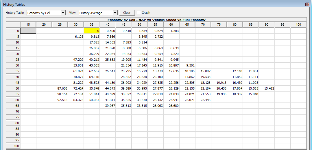

              the numbers i'm getting from mark's equation come out to pretty realistic numbers. interestingly, you can make a "trip computer" using the histograms function in combination with this guage. make one chart for everything, that way you get a true MPG number for the full trip. then make another to show the individual cells to show you where you are getting the best economy at.
                HELL YES, check this action out! my latest drive and therefore log.
                i'm happy about the ~31MPG i'm getting, even when including idling.
                vertical axis of the full table is MPH, and the horizontal axis is MAP.
                  • 9185
                  I'd be interested in 2-3 full tank calcs and comparisons. Until then, its just funny math...
                    i'll be getting there soon enough, but the trip calc seems correct, at least for when the wife is driving, manages to pull an awesome 23MPG...
