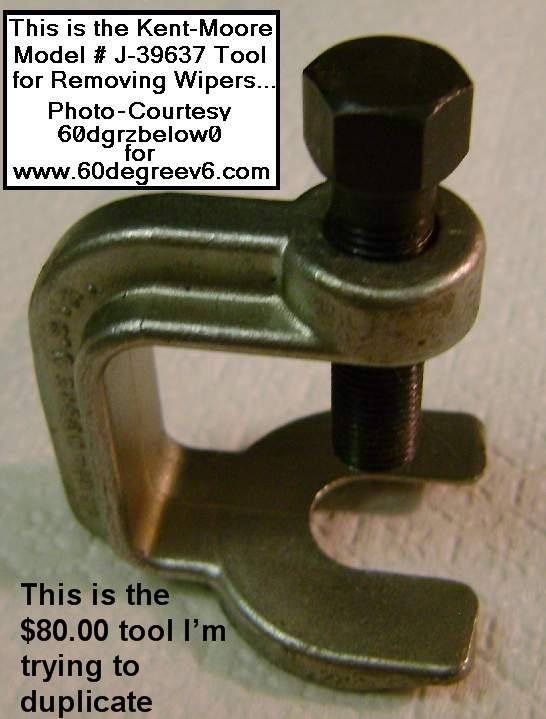

    This is what I mean: (This is the infamous Album that covers the now very successful “FrankInjector EFI Cleaning Machine Project”)

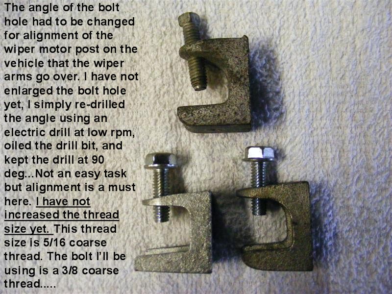

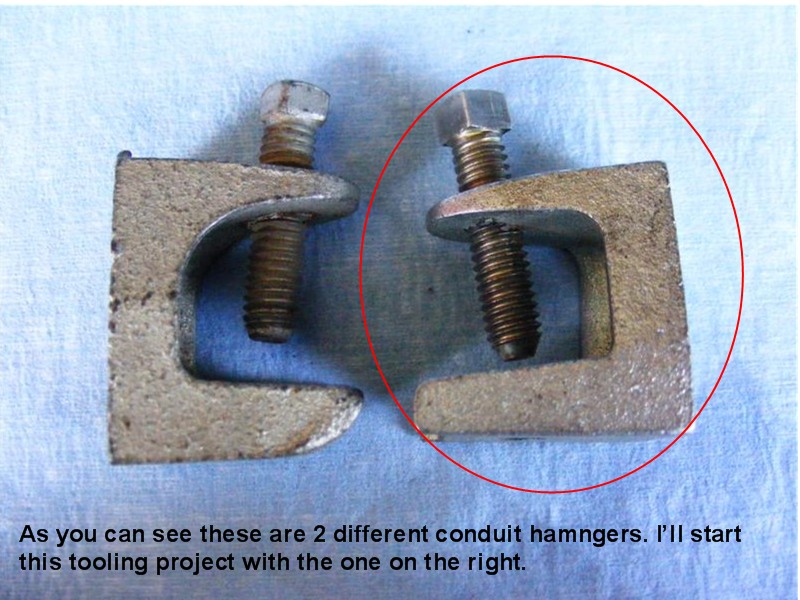

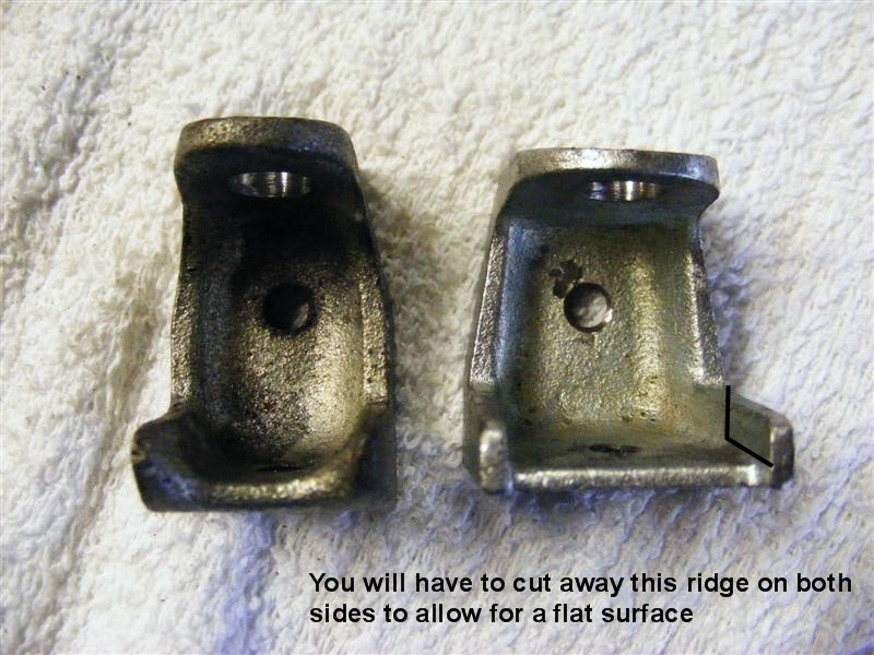

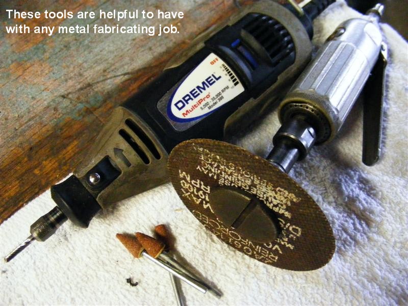

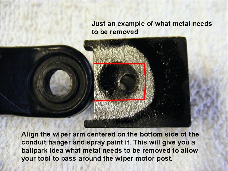

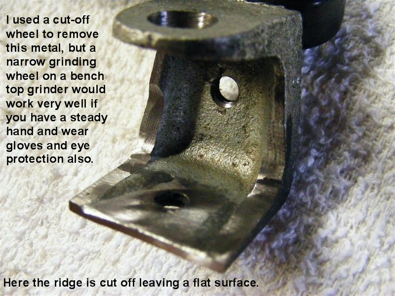

          Completed home made wiper arm removal tool...
          I have finished the home made GM wiper arm removal tool that i plan to use on my 1997 monte carlo. Here are some pictures i took illustrating what tools i used, some proceedures and stuff like that. I will write out a proper documentation after i try to use this tool to remove my wiper arms. Confidence is high.....Tom
Name:	Kent Moore removal tool.jpg
Name:	1 Useful tools.jpg
Name:	2 choose conduit.jpg
Name:	3 re-drill to align.jpg
Name:	4 Ridge needs cut.jpg
Name:	5 Conduit slot cut-out.jpg
Name:	6 Flat surface.jpg
Name:	7 Finished WiperArm Puller.jpg

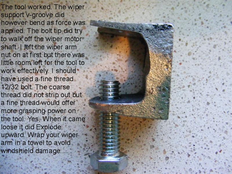

            Tool worked......but
            The tool worked but with minor flaws. Please see attachment
Name:	Tool worked.jpg
                [ATTACH]3669[/ATTACH]
                Doh! Maybe putting some tension on the bolt there, and give it a firm smack (not brutal) with a hammer would have made it pop off?

                  ...and then the glancing blow went... PhuuuuuuuK.... (Queue Music...Go to Commercial...)
