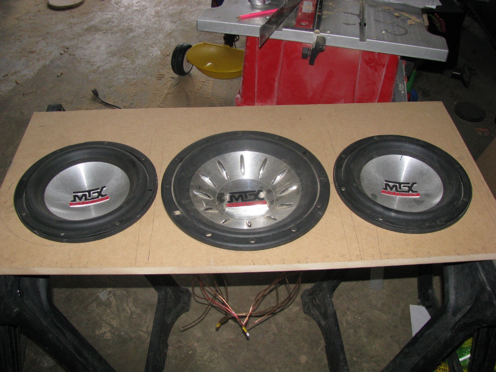

  • nixtux
    • Nov 2007
    • 282
    It's coming along. I haven't settled on precise depths yet since my friend and I ended up centering the holes. I think the 12" will be a little deeper than the
    10's. However the volume is looking good to meet MTX's s recommended specifications for a vented enclosure. The vents haven't been cut yet since it
    turned out we didn't have enough material.
    The 12" is about six, close to 7 years old, so it's a bit rough in appearance but it still sounds good. By no means is it as clear as the 7500's.
