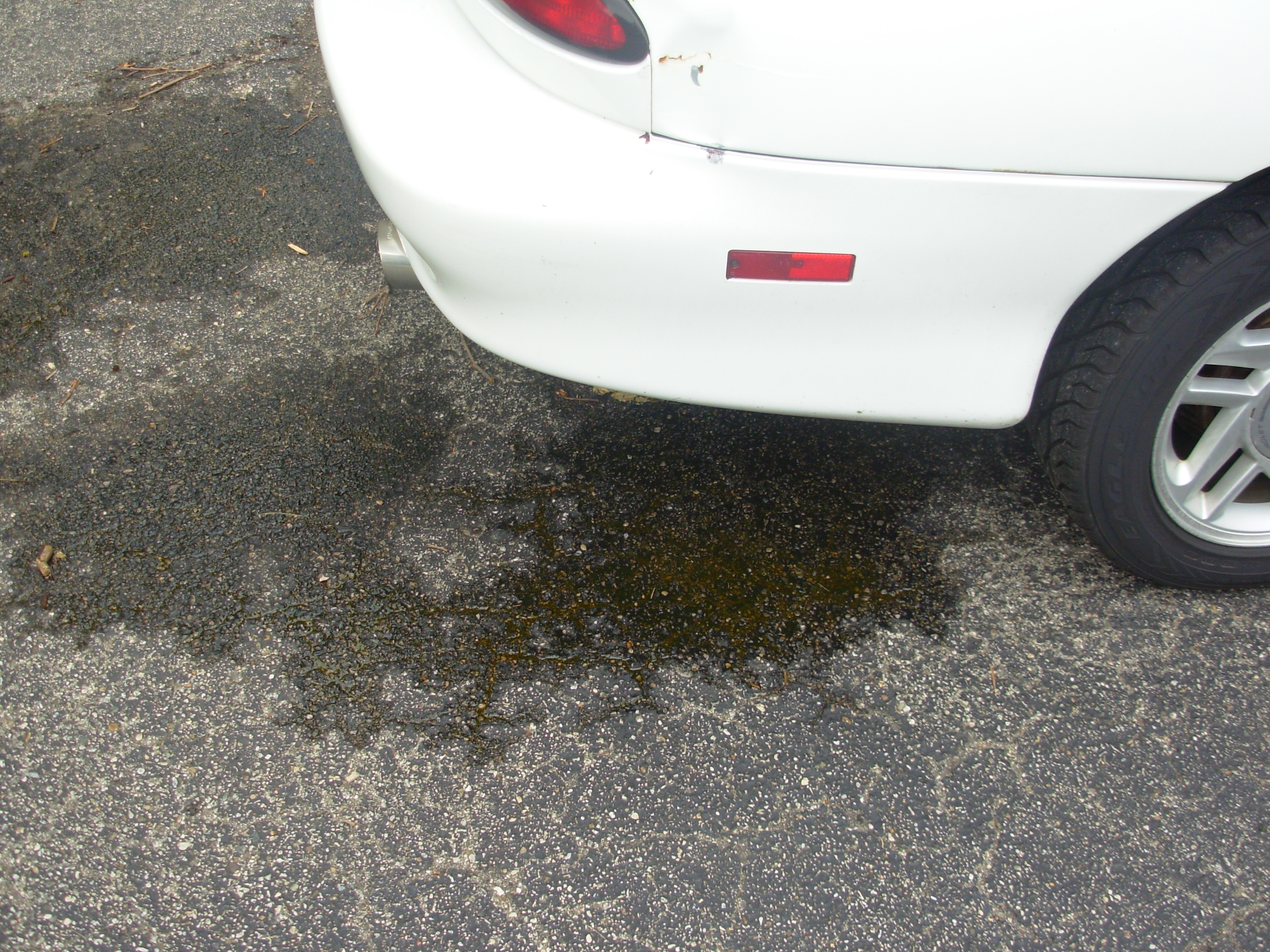

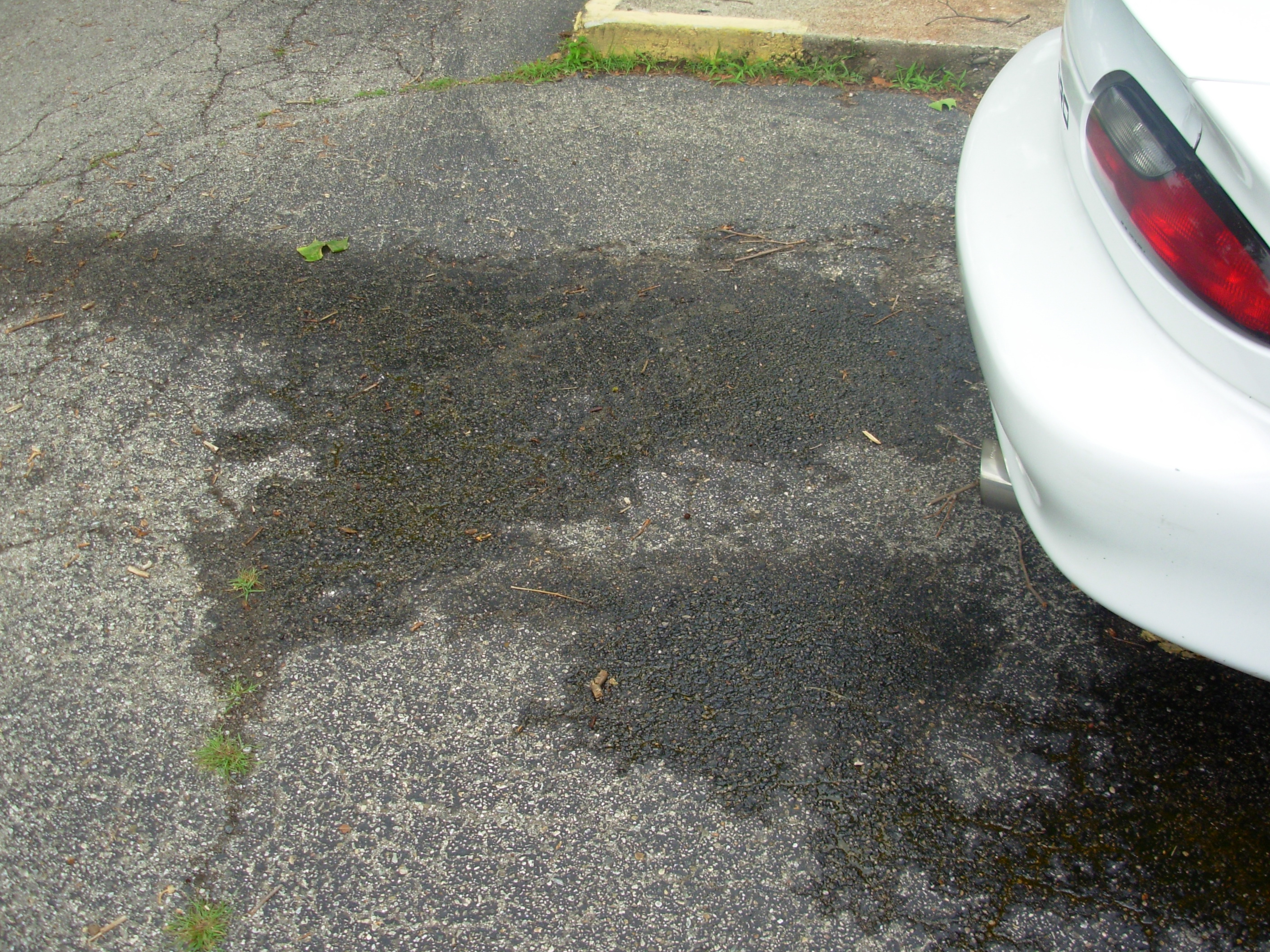

    I sat in the parking lot of the Dollar General store, while my wife shopped. RATT was cranked! I felt good! Time to leave, started her up, noticed a slight miss. No big deal. 4 blocks from home, at a stoplight it happened. Anyone remember the Camry smoke video? That was me when I left the stoplight. Only it came out of the exhaust. No one but me could see to move but me. Got her back and let her calm down a bit. Refired, shot about a gallon of anti-freeze out the back.
    I'll take pics of the teardown, but I know what I will find. (no oil and water mixed) Headset! Guess I won't watch the race tomorrow! Yes, I'll get the heads done while they are off. When your are driving a Chevy, at least today, everything behind me was a blur.

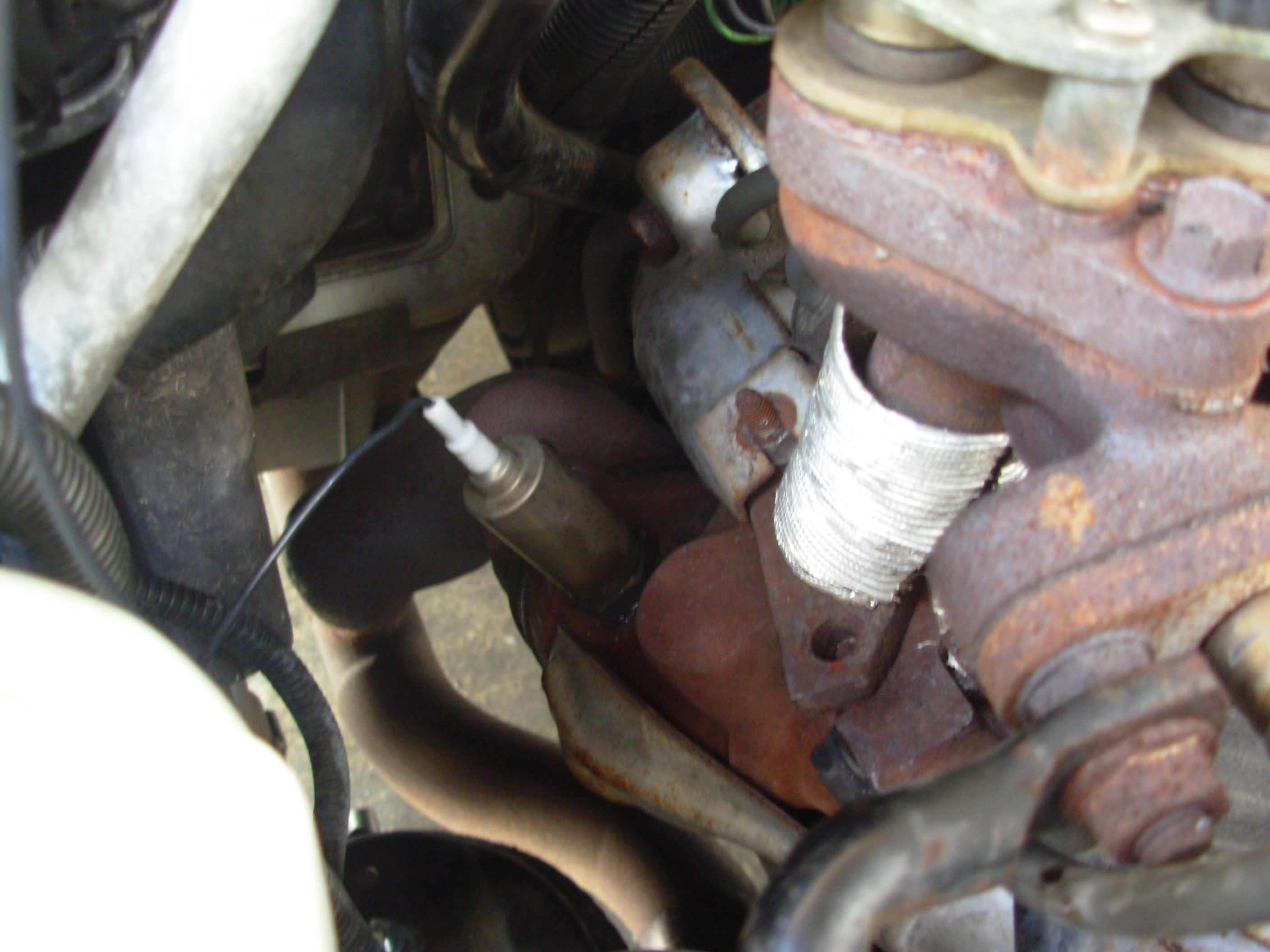

                  2 things: #1: NEVER BUY A #>$ CAMARO! #2: NEVER WORK ON A #>$ CAMARO! See pics.
                  I'm in it. Back is better, got the damn plenum and intake off. My arms told me get the motor out of this bitch! So,...that is what I will do. I can see no safe way to tear down and fix other than that. Now comes questions. Can I pull the engine without removing the AC condenser? Can I replace the engine in a complete state? Intake and plenum installed. Haynes says no, but, there are always tricks. PLEASE tell me there is a trick! BTW, before you ask, it has to come out the top. No lift.
                  #2 pic shows some idiots idea of a cruel joke. Taking off the EGR. WTF? Killing all engineers........

                    Congrat's, you just found the number exhaust leak on these birds. As for pic #1, I feel your pain. This is my existence. Right now I'm in the middle of a heater plenum changeout on a Town Car. Now I know where they got the idea from for plastic razor blades. . . . . . LOL

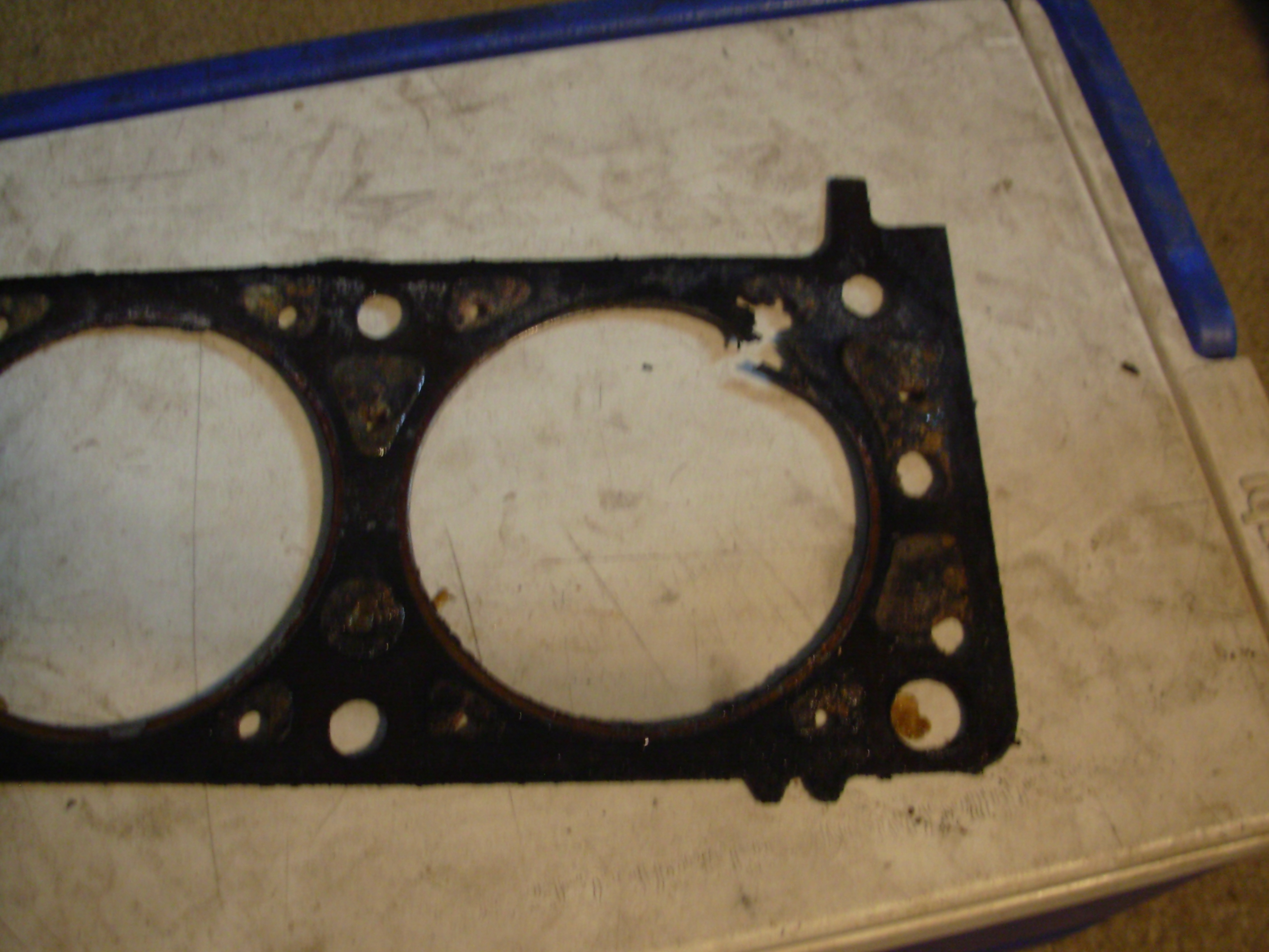

                          3 transfusions, many expletives, thrown wrenches, and a case of beer later. Thar She Blows! Of course it was the hardest head to get off, not that I would have done 1 anyway.
                          Now, out with the die grinder, sander and duct tape. It will go back together without bloodshed. No new cam, just water pump, chain set....
