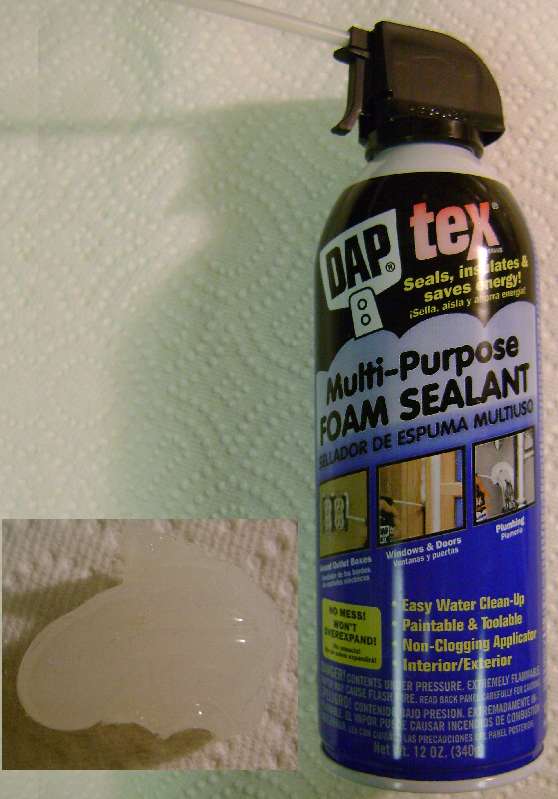

    Also... it follows on that whenever the refrigerator door is closed, the system is designed to create a partial vacuum inside that served to suck the loosened plug upwards from inside the service hole breaching the lower Ice Box...and finally... it just popped its rubbery self upwards and eventually...worked itself out of the smooth, white plastic hole! Could it be that simple? YES! So next...was the problem of coming up with a the solution in the form of a sealer that could both re-seal this hole and also hold the tubes firmly in place. This came in the form of a pressurized can of DAP-Tex Multi-purpose Foam Sealant. I needed something in there though that would be neither noxious, nor so expandable as to foam up all over the place and flow out of the hole. A few vigorous shakes of the can and a good long spray down that hole did the trick. I was able to use just a little tap water on my index finger to smooth the new foam plug over and make it look professional. I let the plug set for about 15 minutes after slowly closing the door...lest the new plug get vacuumed out of the hole as easily as the former one did.
    This story ends happily now that the interior of the Ice Box is maintaining a cold setting that reads out at 41 (Correction...36 Degrees F as measured with a K-Style Thermocouple). So if you are having anything as mysterious as this happening to your own "Ice Box".. .you can make the situation "Chill Out" with ease using this new DAP-Tek sealant! The Case of the "Red Hot" Refrigerator is Solved!
