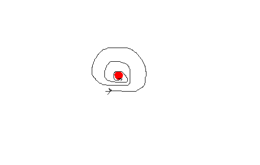

    shrinking metal requires you to heat up a dime sized area, once red hot put the dolly in one hand hold it on the backside of the panel, then take your hammer and tap while moving dolly and hammer in a circlular motion around the dime sized area, takes alot of practice, took me like 2 days to master in autobody school
    you can use these
    think of doing this (attached image)
