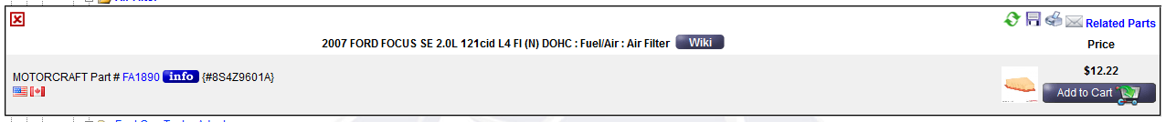

                  FORD wants $350 for a filter or the local parts store does?
                  • Alxsmt
                    that one guy
                    • Feb 2007
                    • 725
                    still havnt tried anything yet lol. ford is the only place that sells the air filter. I think k&n makes a CAI for it
                      • 9191
                      Wierd, RockAuto has it for $12.22...

                        • Alxsmt
                          that one guy
                          • Feb 2007
                          • 725
                          I dont trust rock auto, ive gotten a few wrong parts from them.. I tried a few autoparts stores. it was about 6 months ago tho, maybe someone has steped up and started making them. the filter is a sealed box.
                          just noticed the pic you posted. thats the car, and I believe motorcraft is a ford brand too. hmmmm. im going to have to look into that
